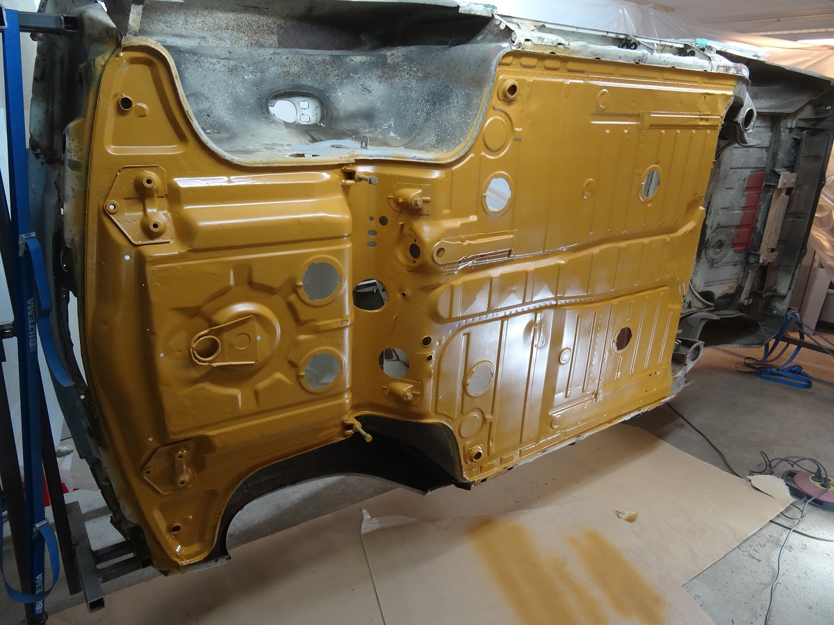

Yes! First paint (primer) is on!

falcor75   Yes! First paint (primer) is on!   Jan 4 2014, 10:19 AM
FourBlades   Nice work! :trophy: Making good progress. ...   Jan 4 2014, 02:01 PM
