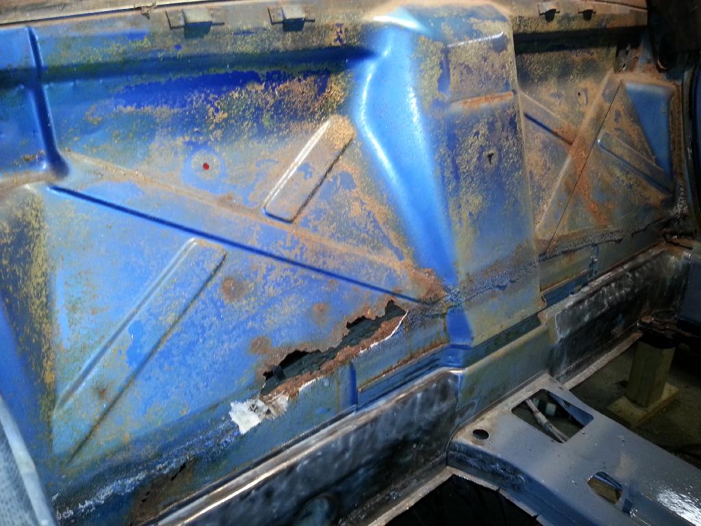

Before...
(IMG:http://www.914world.com/bbs2/uploads_offsite/i1336.photobucket.com-16456-1388886015.1.jpg)

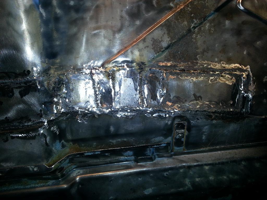

After...
(IMG:http://www.914world.com/bbs2/uploads_offsite/i1336.photobucket.com-16456-1388886015.2.jpg)
That last patch was a real PITA. There is a contour to the top of the lower inner firewall so making that bend and the bend to the middle "hump" was very difficult. I made a long rectangle, bent the flange, split the flange for the hump bend and then made several splits for the contour bend. It's not a pretty patch but it will work. In addition to the spot welds on the engine bay side where the two flanges meet, I also seam welded the middle and drivers side patches along the bottom. At the factory they only welded about 3' on each side and the rest of that area was seam sealed. That's were all the rust started. I cleaned everything up, treated with metal prep and slathered on the POR 15.

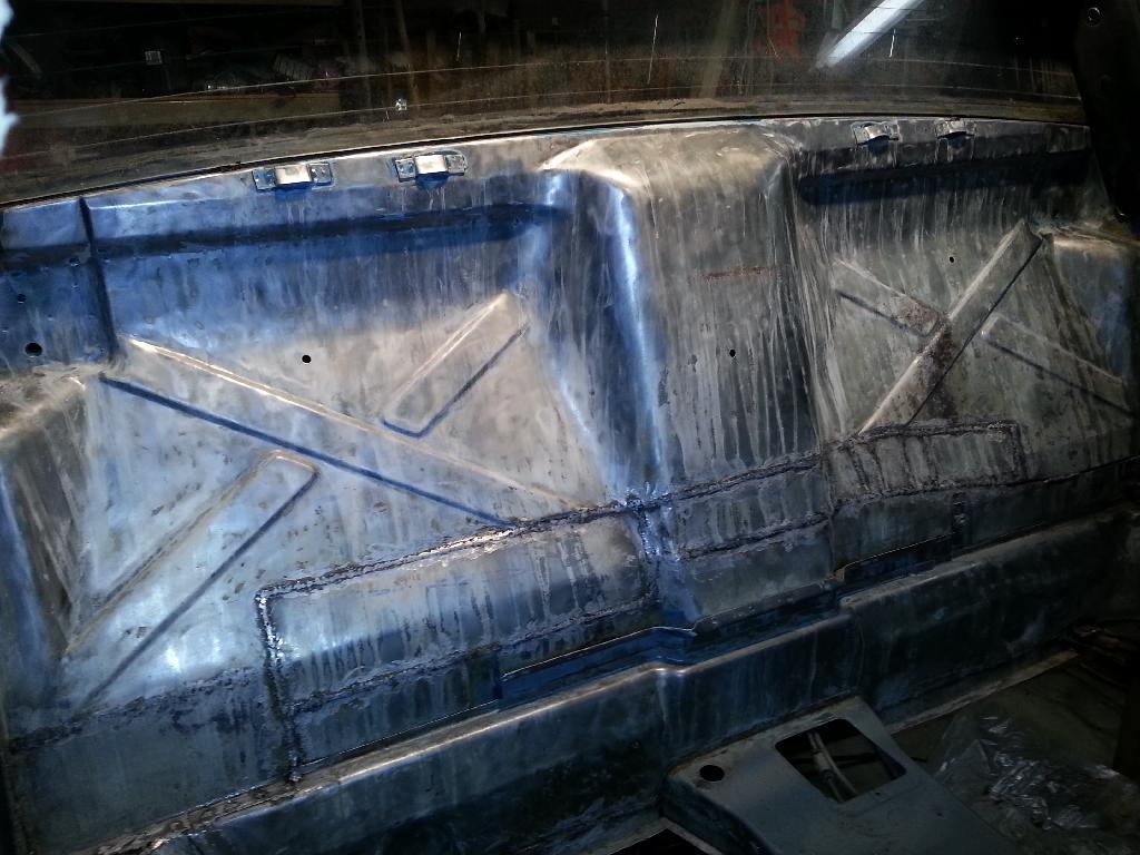

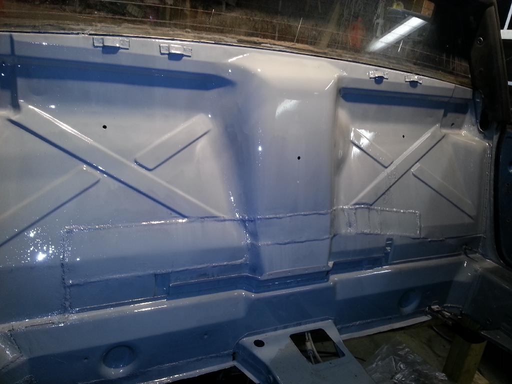

Next up will be to raise the car some with my hillbilly lift and start cleaning up the engine compartment. It's dark, dirty and that process is not going to be pleasant.
(IMG:http://www.914world.com/bbs2/uploads_offsite/i1336.photobucket.com-16456-1388886016.3.jpg)
(IMG:http://www.914world.com/bbs2/uploads_offsite/i1336.photobucket.com-16456-1388886016.4.jpg)
