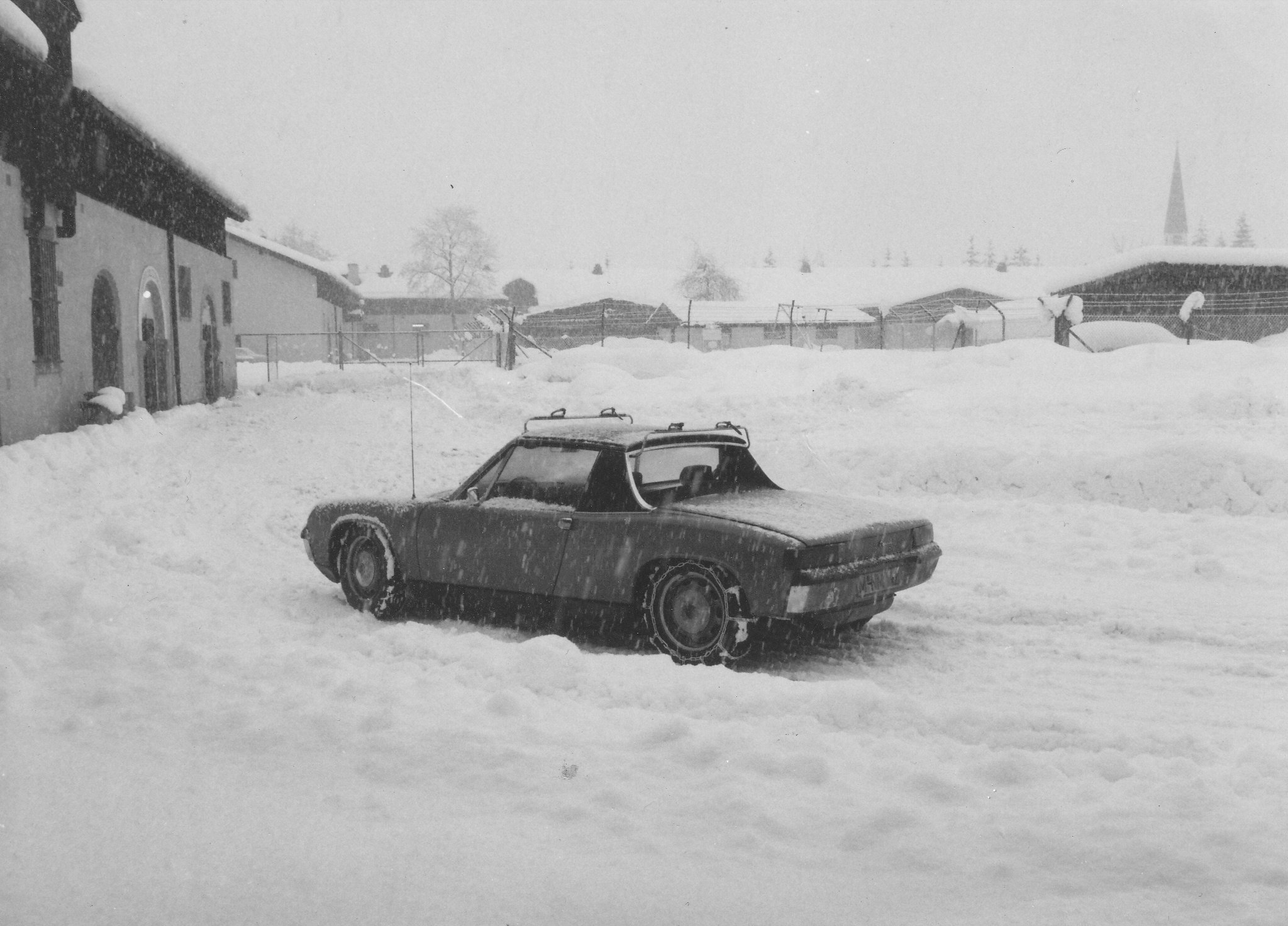

Regarding the discussion of the holes in the windshield frame; this is a picture of my 914/6 with a ski rack. The front bar fit the holes in the windshield frame. The rear bar was attached with screws into threaded holes under the rollbar.
The pictures aws taken in Bertschesgarten, Germany during the winter of 1972/73.
