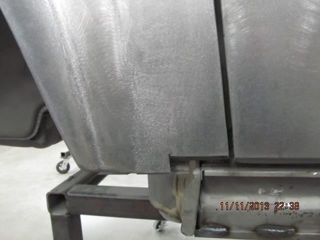

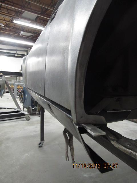

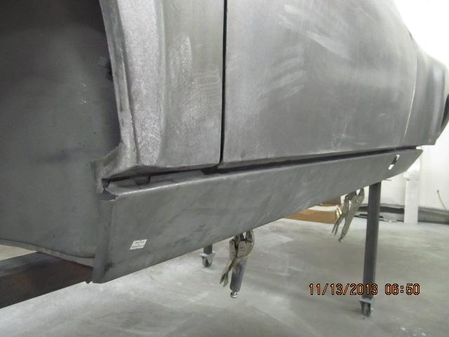

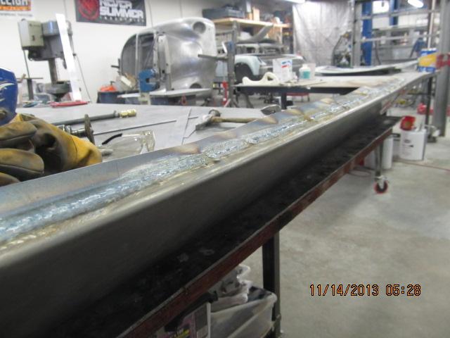

Right hand rocker build.next body in primer...
