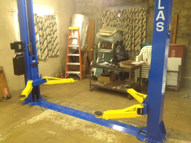

I just purchase and picked up a 2 post lift. It's an Atlas BP 8000 symmetrical lift. I have 27" on either side of the posts. I want to position as close to the front wall as possible, but still leave enough room to walk around the front of my 914. Any suggestions as to the distance from the post to the front wall ? My initial guestimate is 10 feet???

The lift installation is done. My electrician wired it up this week and I lifted the first vehicle Thursday night. Other than a few minor adjustments, everything went pretty smooth. As I might have mentioned before, the directions aren't that complete which added some time to the project. We installed another lift yesterday and it took only 2 1/2 hours, not counting the unpacking. You will need a minimum of 2 people, preferably 3, to hoist the posts to a vertical position. Anyone contemplating installing one can contact me with any questions.
