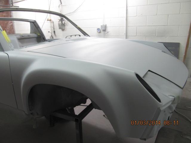

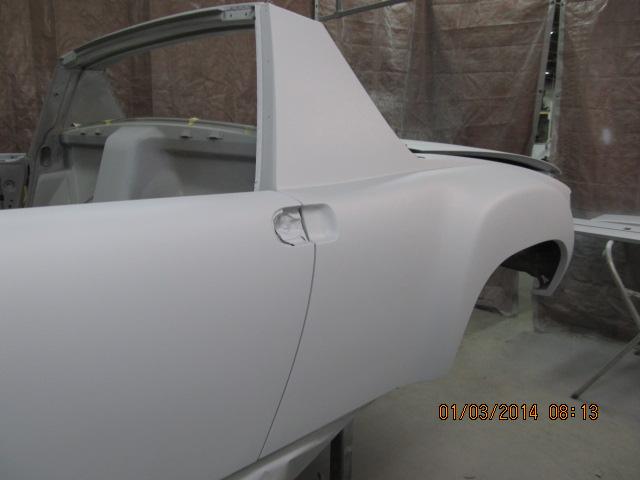

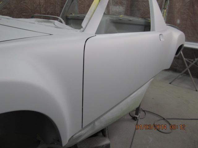

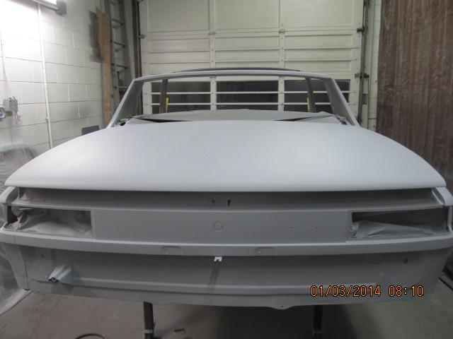

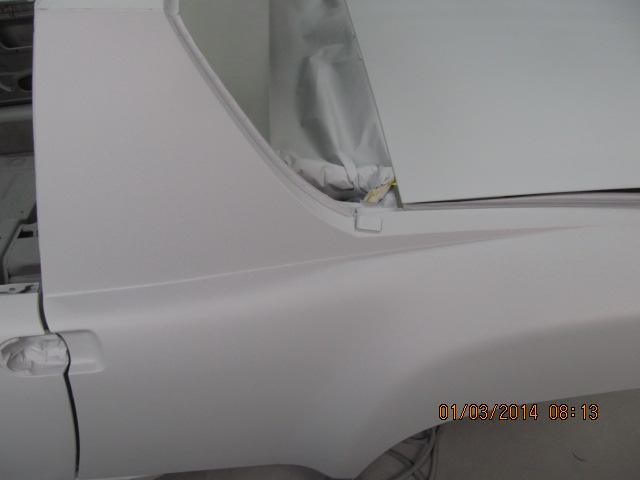

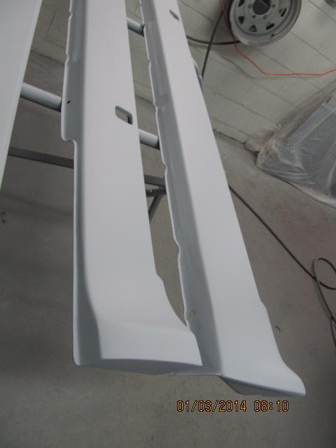

post Jan 12 2014, 01:29 PM
Posts: 128
Joined: 8-September 12
From: Denver,Colorado
Member No.: 14,902

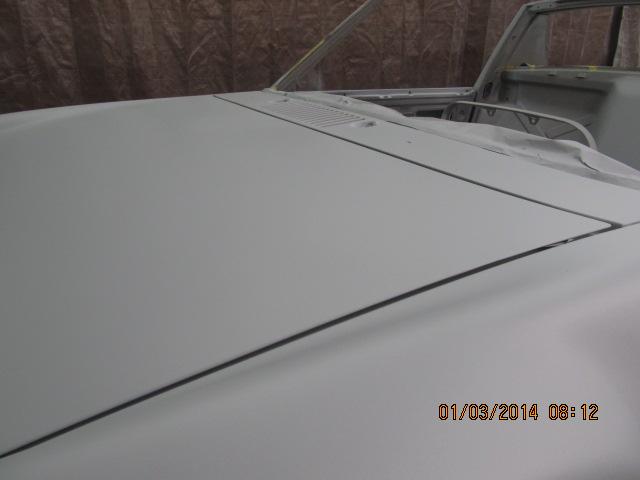

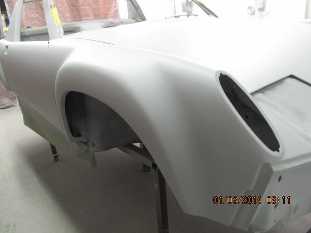

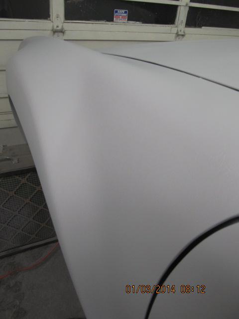

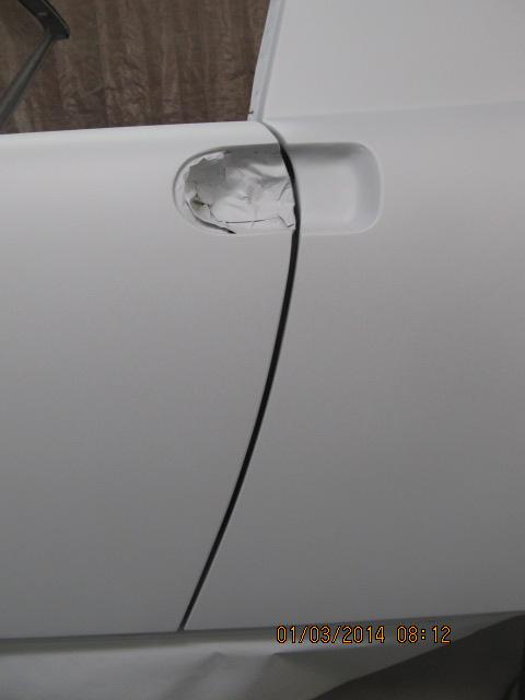

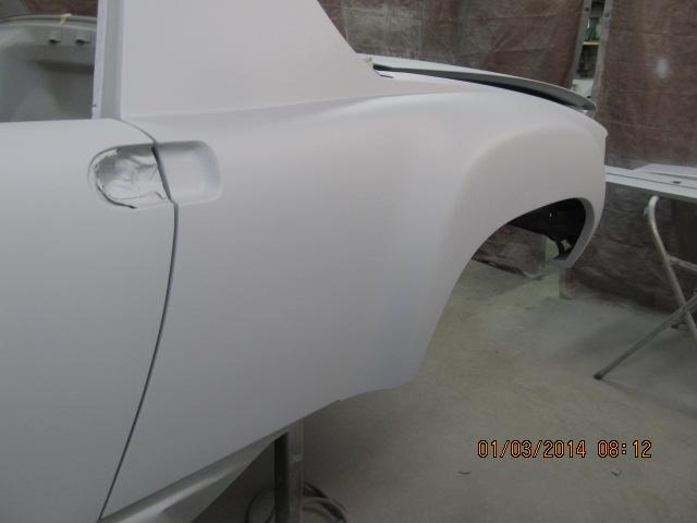

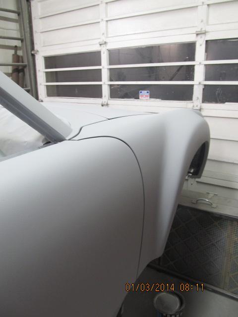

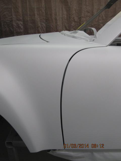

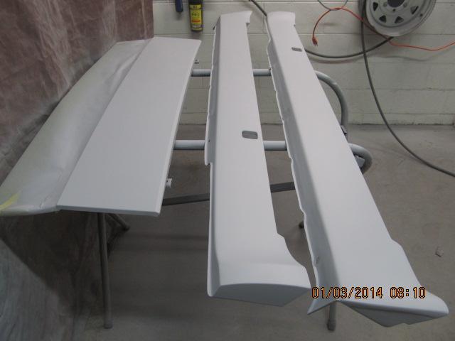

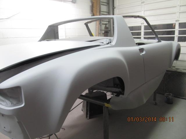

and in first stage primer......
(IMG:http://www.914world.com/bbs2/uploads_offsite/images.thesamba.com-14902-1389554965.1.jpg)
(IMG:http://www.914world.com/bbs2/uploads_offsite/images.thesamba.com-14902-1389554965.2.jpg)
(IMG:http://www.914world.com/bbs2/uploads_offsite/images.thesamba.com-14902-1389554965.3.jpg)
(IMG:http://www.914world.com/bbs2/uploads_offsite/images.thesamba.com-14902-1389554965.4.jpg)
(IMG:http://www.914world.com/bbs2/uploads_offsite/images.thesamba.com-14902-1389554965.5.jpg)
(IMG:http://www.914world.com/bbs2/uploads_offsite/images.thesamba.com-14902-1389554965.6.jpg)
(IMG:http://www.914world.com/bbs2/uploads_offsite/images.thesamba.com-14902-1389554965.7.jpg)
(IMG:http://www.914world.com/bbs2/uploads_offsite/images.thesamba.com-14902-1389554965.8.jpg)
(IMG:http://www.914world.com/bbs2/uploads_offsite/images.thesamba.com-14902-1389554966.9.jpg)
(IMG:http://www.914world.com/bbs2/uploads_offsite/images.thesamba.com-14902-1389554966.10.jpg)
(IMG:http://www.914world.com/bbs2/uploads_offsite/images.thesamba.com-14902-1389554966.11.jpg)
(IMG:http://www.914world.com/bbs2/uploads_offsite/images.thesamba.com-14902-1389554966.12.jpg)
(IMG:http://www.914world.com/bbs2/uploads_offsite/images.thesamba.com-14902-1389554966.13.jpg)
(IMG:http://www.914world.com/bbs2/uploads_offsite/images.thesamba.com-14902-1389554966.14.jpg)
(IMG:http://www.914world.com/bbs2/uploads_offsite/images.thesamba.com-14902-1389554966.15.jpg)
