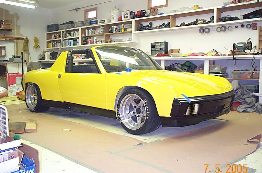

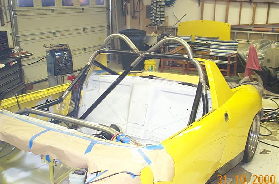

My cage builder would be me. I did it twice.
Running down tubes to the shock towers the second time.......the best mod I ever did to the shitbox......live & learn, eh? The halo was more dangerous than no cage at all. ........Attached Image

J P Stein   My cage builder would be me. I did it twice. Runni...   Jan 13 2014, 08:53 AM
J P Stein   I did start with a a car as rust free as possible ...   Jan 13 2014, 09:01 AM
