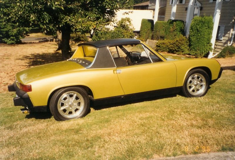

J P Stein   I paid 4500 bucks for that green car back in the l...   Jan 17 2014, 09:23 AM
