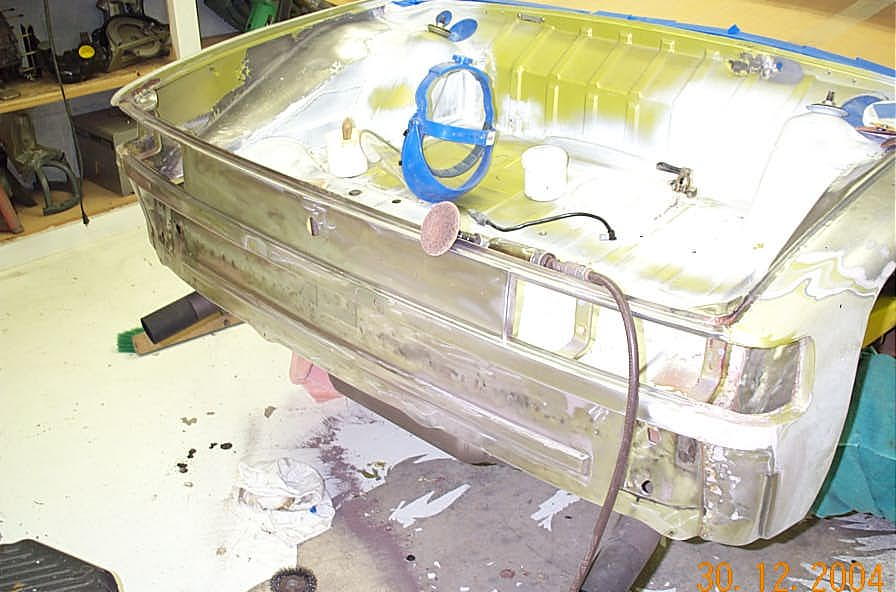

I paid 4500 bucks for that green car back in the late 90s. It looks better than it was having taken hits in each corner (fender benders) and the paint was falling off in sheets
"The plan" didn't include making it a full ime race car.......but there is the "slippery slope" personified.
By the time I was done selling parts off the car, it maybe cost (WAG) $1K, minus the agravation and had a solid chassis (for a 914) to boot. .....
