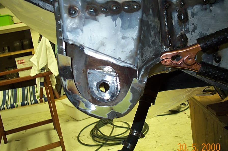

J P Stein
post Jan 19 2014, 09:34 AM
Irrelevant old fart
Posts: 8,797
From: Vancouver, WA
Member No.: 45
Well, if you must.......
You are into an area that is a well known weak spot of the 914....race car or not, they have been known to rip that ear right off.
"while you're there" you may want to make a fix to prevent this. If you're not interested in my input, just say so and this will be the last you'll hear from me.

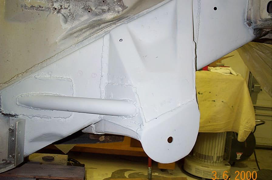

Over the top of this went a 3/16 plate & on the sides
Weld the hell out of all seams & everything.

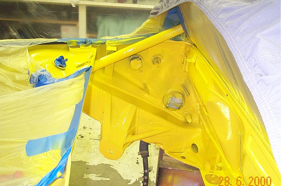

Paint to match
