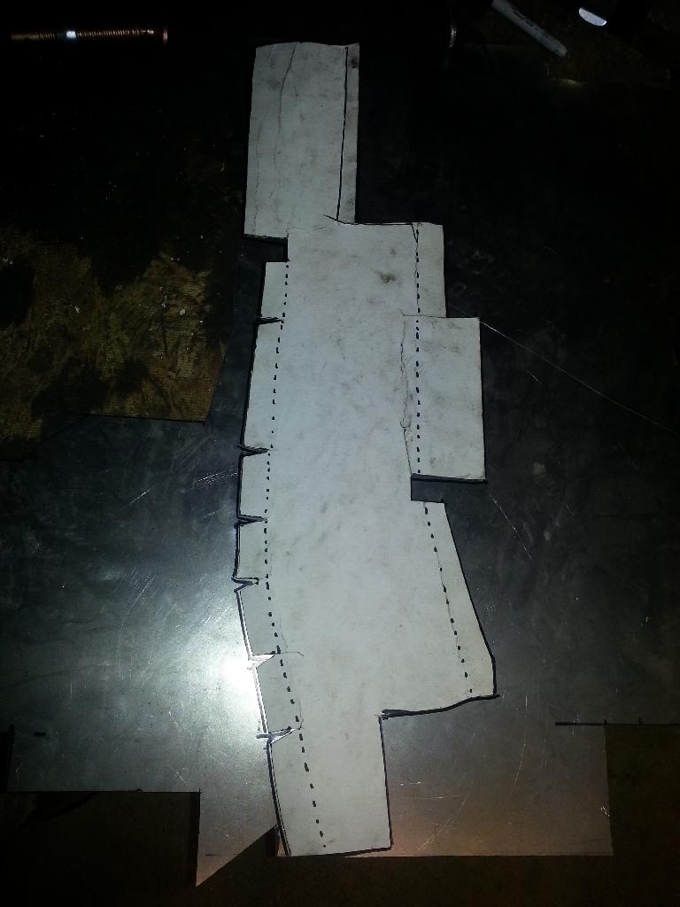

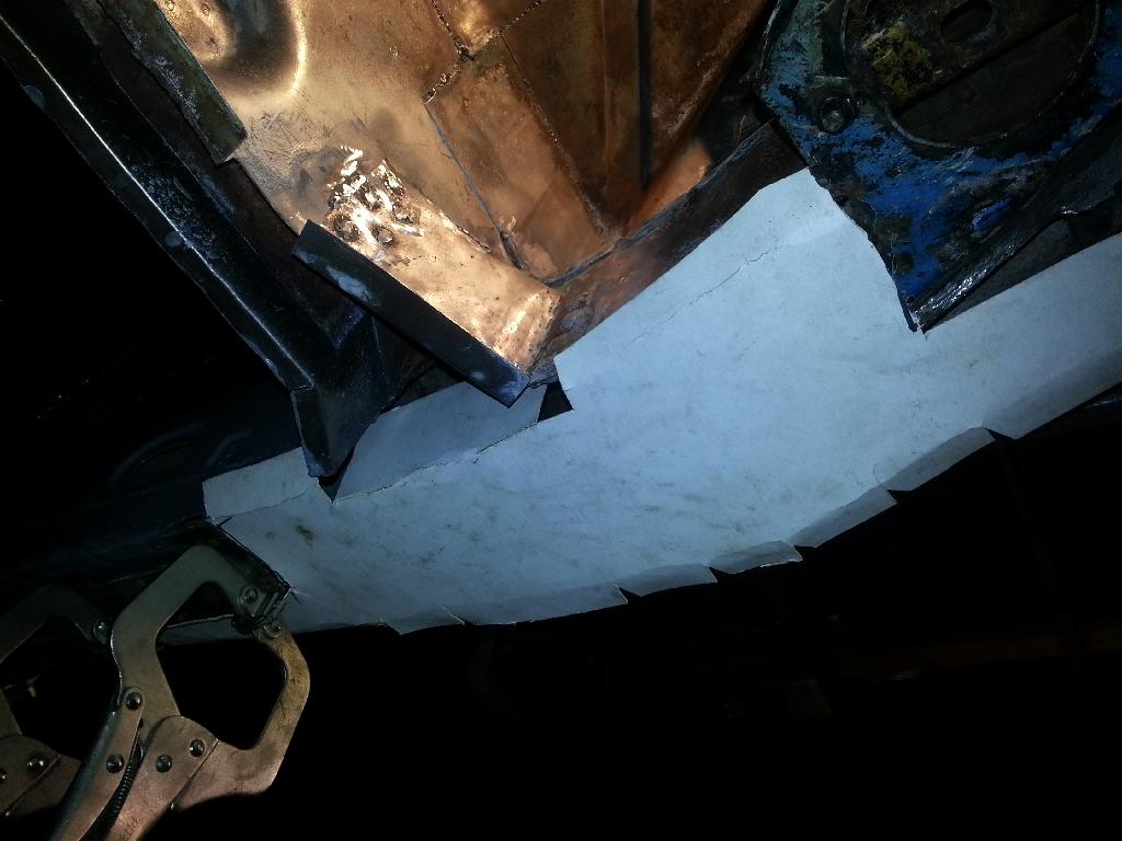

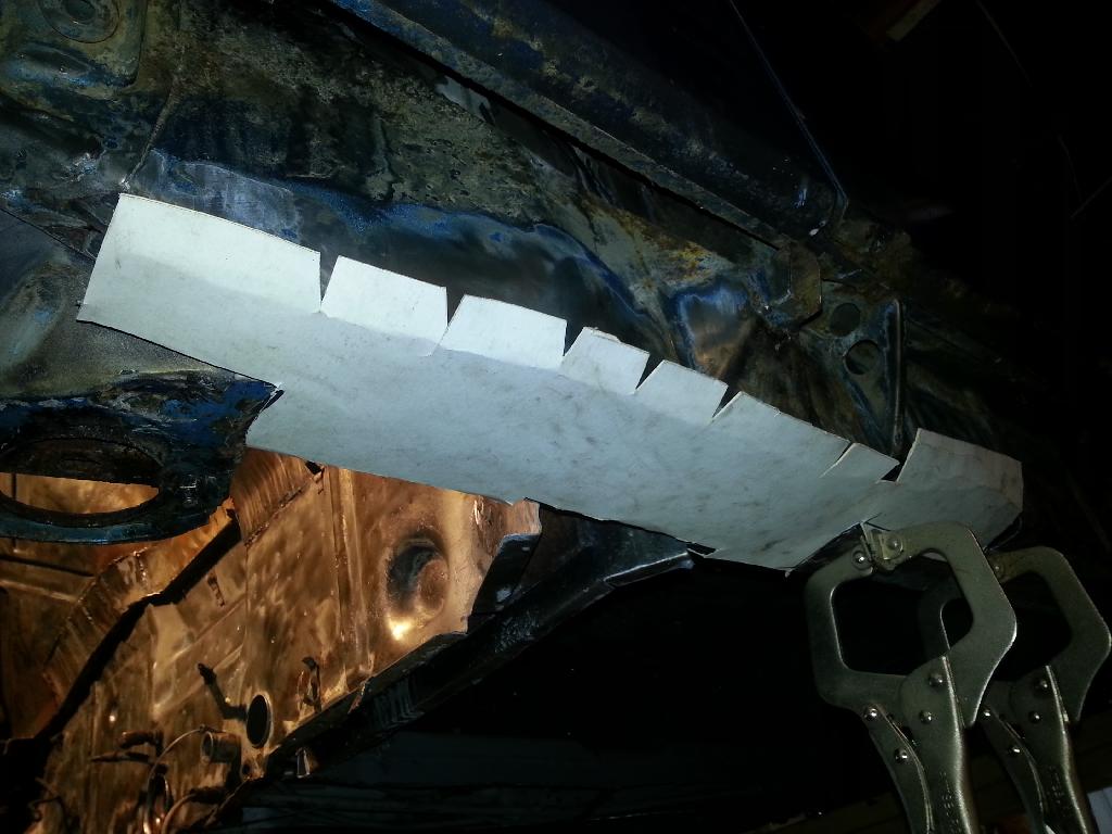

This next patch is going to be REALLY tough. It's going to cover the underside of the long from about 12" forward of the firewall to almost to the out-board suspension attachment point. It took me 1 1/2 hour just to make the template. I'm still thinking one continuous piece of metal is the best way to go. But if I start to really struggle forming this - I may have to chop it into segments.
