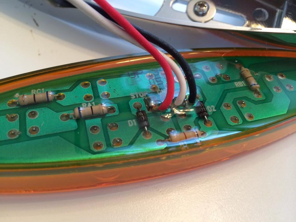

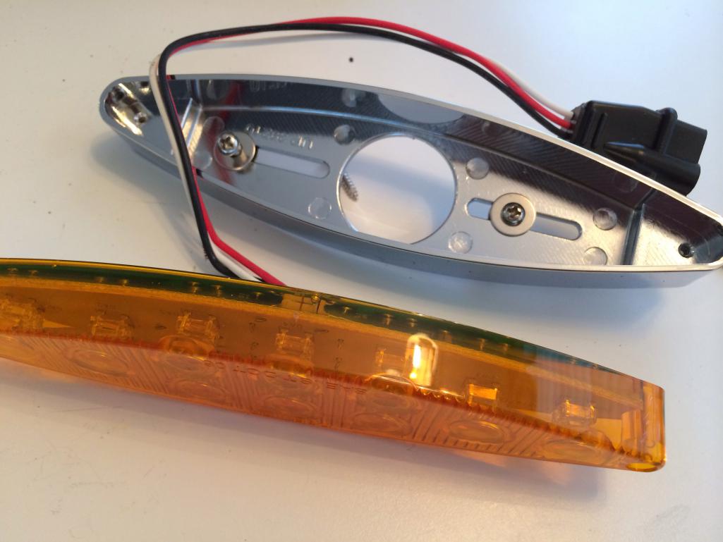

I had an idea a few weeks ago to re-fit the front light bucket with a more substantial light pack. LED...bright...yada yada.
Found a set of "cat eye" amber LEDs on eBay and the sizing was close enough, I figured I'd give it a try.
They showed up yesterday and immediately I could tell that these would likely work REAL well. But how was I going to mount them?
CptTripps
post Jan 25 2014, 01:29 PM
:: Punch and Pie ::
Posts: 3,585
Joined: 26-December 04
Member No.: 3,342
After some tinkering, I realized that I may have been over-complicating things. I had everything I needed right here.
I started tearing them down. Great quality on the packs BTW. Dot approved, so you Californians can use them. (No "off road only" disclaimer.
