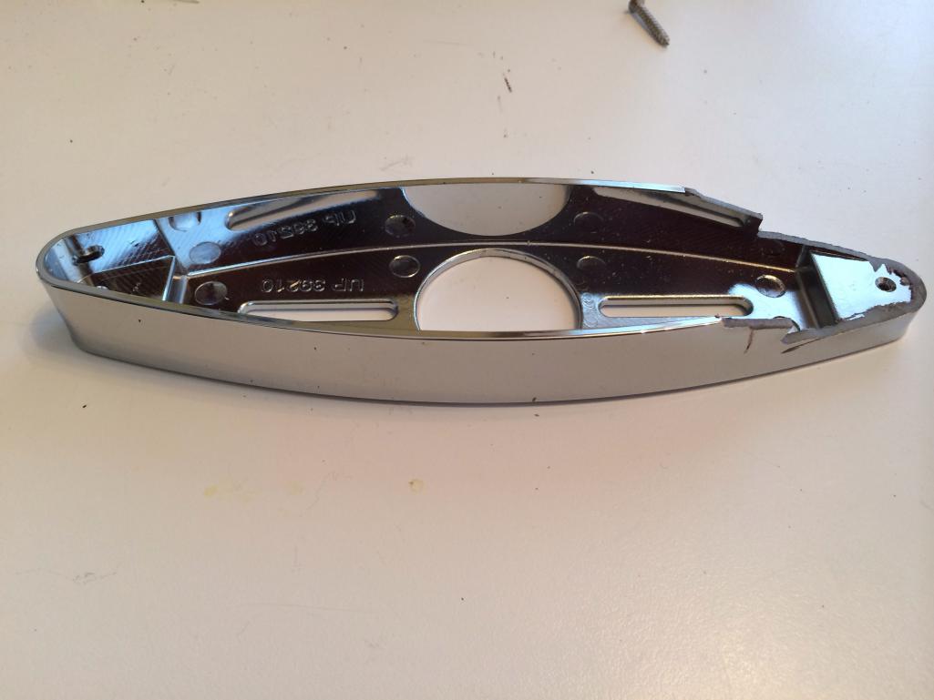

I had an idea a few weeks ago to re-fit the front light bucket with a more substantial light pack. LED...bright...yada yada.
Found a set of "cat eye" amber LEDs on eBay and the sizing was close enough, I figured I'd give it a try.
They showed up yesterday and immediately I could tell that these would likely work REAL well. But how was I going to mount them?
CptTripps
post Jan 25 2014, 01:32 PM
:: Punch and Pie ::
Posts: 3,585
Joined: 26-December 04
Member No.: 3,342
Took the housing and flipped it upside-down. It was almost perfect to use as a mount inside the bucket, but needed a little dremeling.
I just took enough off of one edge that it sits in there at an angle.
This will let it be more at a right angle for the benefit of other cars that need to see you.
