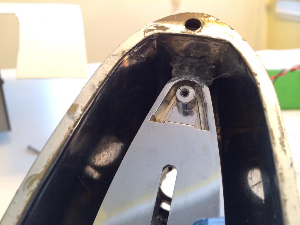

I had an idea a few weeks ago to re-fit the front light bucket with a more substantial light pack. LED...bright...yada yada.
Found a set of "cat eye" amber LEDs on eBay and the sizing was close enough, I figured I'd give it a try.
They showed up yesterday and immediately I could tell that these would likely work REAL well. But how was I going to mount them?

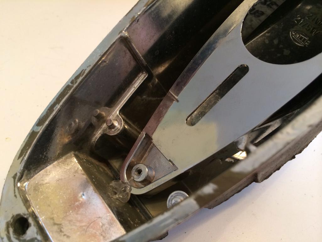

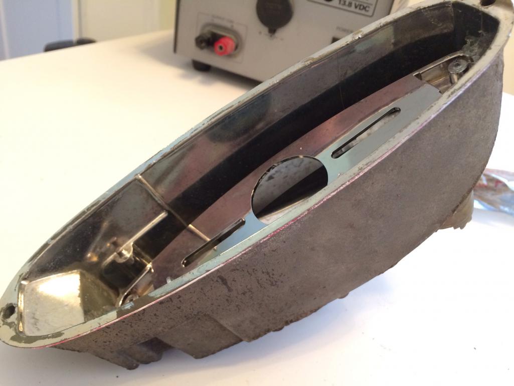

After just a few min, I had it hot-glued into position to test out.
I'll epoxy it in later, but I want to try adding white lights behind this mount at some point. I may be able to do a cool "halo" for DRLs. Later for that though.
