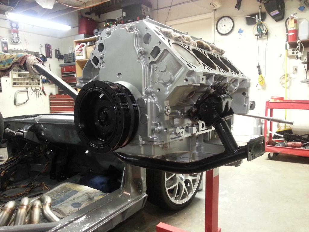

Making more progress, starting to work on the engine. I've decided to leave the engine stock for the time being. I'm going to run the factory cam and heads. Sorting things will keep me busy and having extra HP will only get me in trouble. I didn't realize as well changing out a cam correctly is no small chunk of change. (IMG:style_emoticons/default/blink.gif)
