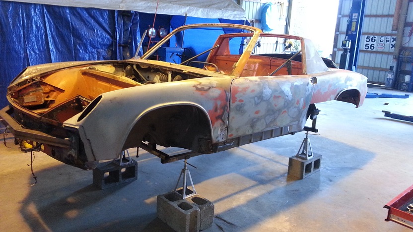

I was wondering if any one has pictures of exactly where to measure body dimension X. Targa bar to windshield frame.
This car was a front clip repair back in the beginning of its life.
http://www.914world.com/bbs2/index.php?act...=2&t=187546
If it needs to be tweaked, now is the time.
TIA for the help ........................

Door is already off .............. (IMG:style_emoticons/default/sad.gif)
We're getting ready to install a double door brace in the hinge locations.
Here's the only picture I have. The fender to door gap is so crappy I don't shoot any pictures of it. Kind of Embarrassing. I've always figured it was going to take some creative craftsmanship like r_towle's been discussing.
I'll get the other measurement this am before we install the door brace. I assume it doesn't matter which latch screw hole as long as its the same on both sides.
I seems odd only one dimension is off.
But with the hillbilly job that was done on the front clip install anything is possible.
