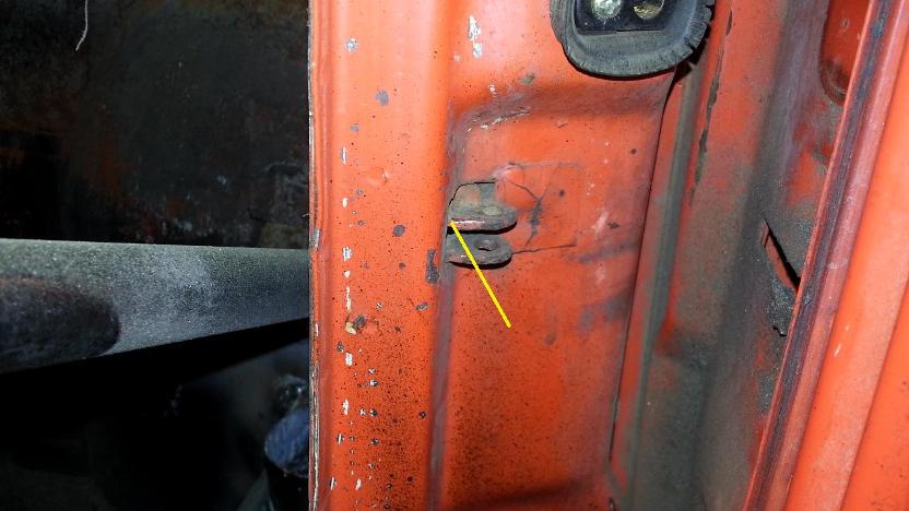

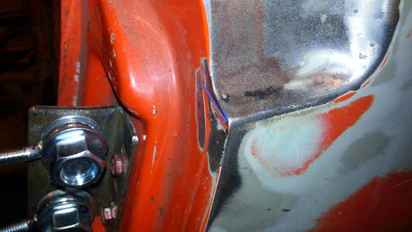

Super In Law is fabricating the new door braces. So I left his brackets in place.
Here's what I measured.
Targa corner to closure pin bracket.
Left : 300 mm
Right : 297 mm
Then I measured windshield corner to rear qtr. door handle.
Left : 758 mm
Right : 763 , oops ..........
All the while the F still measures 638 mm on both sides.
