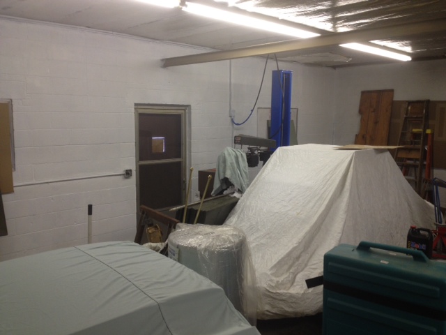

I just purchase and picked up a 2 post lift. It's an Atlas BP 8000 symmetrical lift. I have 27" on either side of the posts. I want to position as close to the front wall as possible, but still leave enough room to walk around the front of my 914. Any suggestions as to the distance from the post to the front wall ? My initial guestimate is 10 feet???

4 gallons of primer, 18 hours of wire brushing, vacuuming and application of primer. Now ready for finish coat.

brant   I think the 914 is about 14 foot on my 2 post, th...   Dec 25 2013, 05:04 PM
The Cabinetmaker   The post of mine is about 12 inches aft of the fro...   Dec 25 2013, 05:12 PM
Eric_Shea   From my experience installing ours, consider the c...   Dec 25 2013, 05:32 PM
Woody   You would do yourself a disservice if you thought...   Dec 25 2013, 08:32 PM
Eric_Shea   Also. Our cars are so light you could pretty much ...   Dec 25 2013, 05:33 PM
r_towle   Pick your longest car or truck and mount it for th...   Dec 25 2013, 05:54 PM

dcheek   The lift installation is done. My electrician wire...   Jan 12 2014, 08:00 AM

dcheek   You installed it in your spare bedroom? Spare wa...   Jan 12 2014, 02:50 PM
dcheek   4 gallons of primer, 18 hours of wire brushing, va...   Jan 30 2014, 02:50 PM
