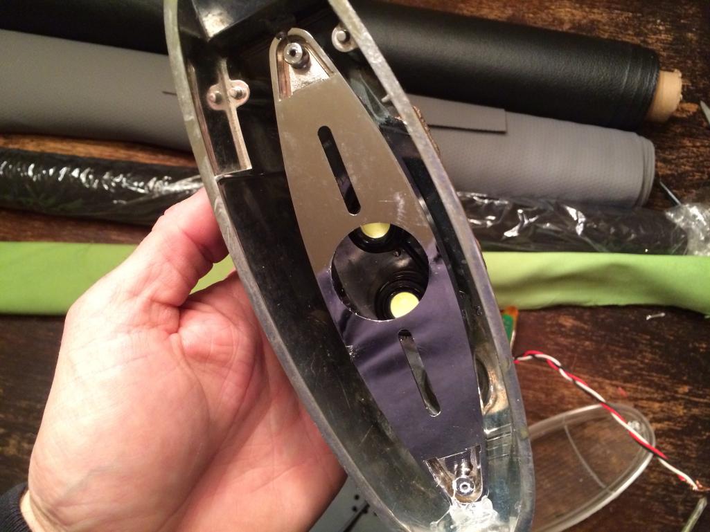

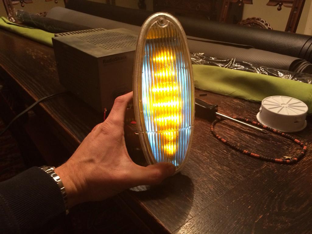

I had an idea a few weeks ago to re-fit the front light bucket with a more substantial light pack. LED...bright...yada yada.
Found a set of "cat eye" amber LEDs on eBay and the sizing was close enough, I figured I'd give it a try.
They showed up yesterday and immediately I could tell that these would likely work REAL well. But how was I going to mount them?

Added 2 white spots behind the light tonight to see if that'd make for a decent DRL idea. You be the judge.

kid914   VERY NIIIIICE! for 25$ you can't beat...   Jan 25 2014, 01:52 PM
Harpo   Love it. Off to ebay to find some "cat eye...   Jan 25 2014, 02:20 PM

Spoke   I've noticed that the blinker in my 71 blinks ...   Jan 26 2014, 12:06 AM
bulitt   So, possibly a resistor will be needed in the circ...   Jan 26 2014, 07:38 AM
bulitt   :agree: Didn't want the Cpt ditching his eff...   Jan 26 2014, 08:12 AM
CptTripps   I was thinking about setting up a flasher relay an...   Jan 26 2014, 09:46 AM
Spoke   I was thinking about setting up a flasher relay a...   Jan 26 2014, 10:53 AM

bulitt   Guess the board electricians will weigh in. Think...   Jan 26 2014, 11:03 AM
mikesmith   You just replace the flasher with one designed for...   Jan 26 2014, 11:41 AM
CptTripps   I ordered a couple different "LED friendly...   Jan 26 2014, 02:28 PM
Mike Bellis   Some of the 914 relays will work with LED's an...   Jan 26 2014, 03:39 PM
914forme   Doug is also using a completely different harness ...   Jan 26 2014, 04:06 PM
3d914   Doug, nice job - I like it! You gonna provide...   Jan 26 2014, 04:26 PM
CptTripps   Stephen is correct. I have a completely custom wir...   Jan 26 2014, 04:27 PM

effutuo101   Some of the LED pre fab lights have built in resis...   Jan 27 2014, 11:28 PM
mikesmith   Some of the LED pre fab lights have built in resi...   Jan 28 2014, 11:25 AM
