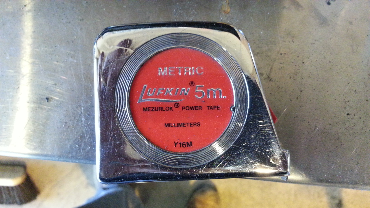

SLITS   Shame, shame ... the tape is not metric.   Jan 25 2014, 04:30 PM
rick 918-S   Shame, shame ... the tape is not metric. Have y...   Jan 25 2014, 04:59 PM
