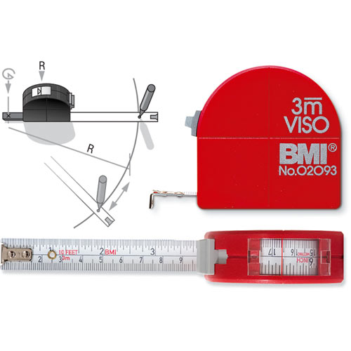

QUOTE(SLITS @ Jan 25 2014, 02:30 PM) *
Shame, shame ... the tape is not metric.
I've been compelled to get one (IMG:style_emoticons/default/biggrin.gif)
- dims on the page are english as well but it might be better to see it in mm, like if they were rounding up, to know that.
The newer luftkins look a bit cheesier than above. The stanley ones are ok-looking. I found one that is german. (IMG:style_emoticons/default/german01.gif) I bought it, but it might take awhile to get here.

QUOTE(nathansnathan @ Jan 31 2014, 10:41 PM) *
(IMG:http://www.914world.com/bbs2/uploads_offsite/www.thetoolboxscotland.co.uk-11782-1391229693.1.jpg)
Where are you getting that one from? It's cool.
