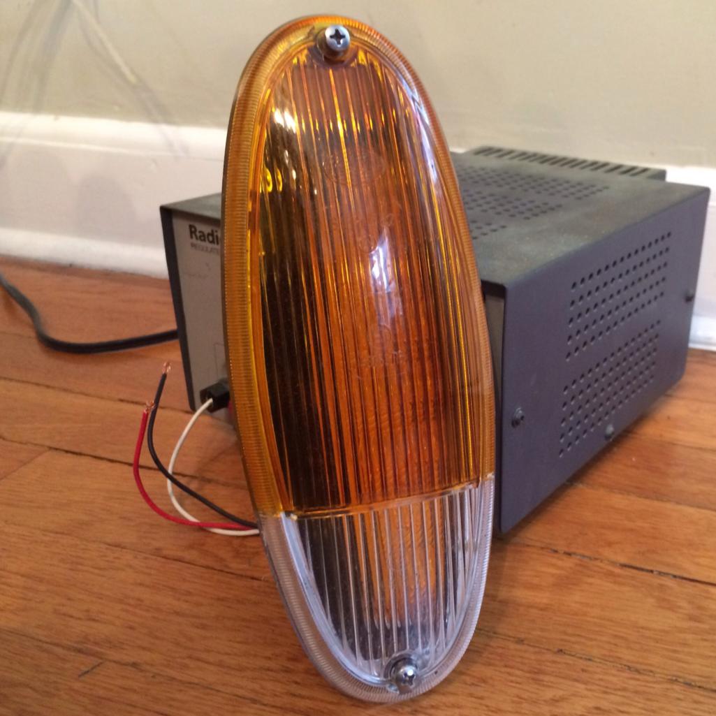

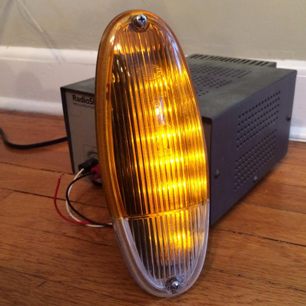

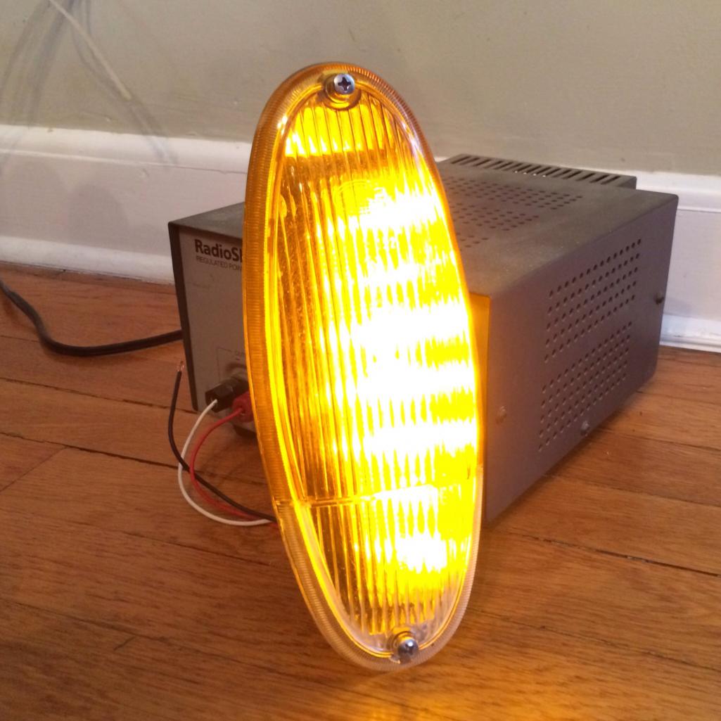

I had an idea a few weeks ago to re-fit the front light bucket with a more substantial light pack. LED...bright...yada yada.
Found a set of "cat eye" amber LEDs on eBay and the sizing was close enough, I figured I'd give it a try.
They showed up yesterday and immediately I could tell that these would likely work REAL well. But how was I going to mount them?

Turns out that my amber lens is a Euro lens, so here goes. You get the idea.
https://www.youtube.com/watch?v=VRYuFVIluiE
Hope that helps.
