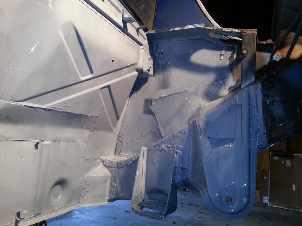

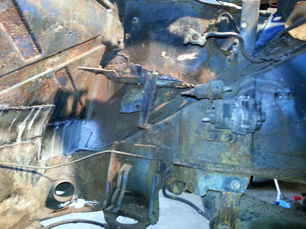

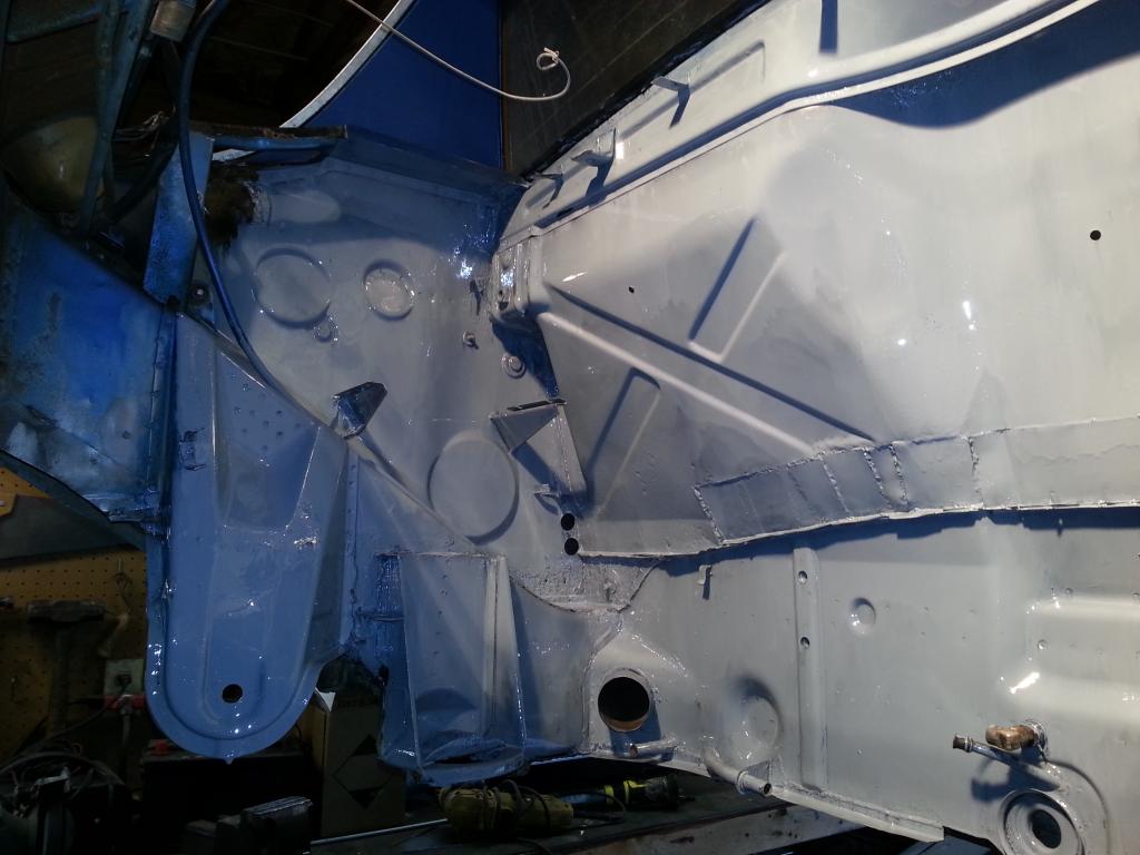

Engine compartment mostly done.
Before...
(IMG:http://www.914world.com/bbs2/uploads_offsite/i1336.photobucket.com-16456-1391317428.1.jpg)
After...
(IMG:http://www.914world.com/bbs2/uploads_offsite/i1336.photobucket.com-16456-1391317429.2.jpg)
Before...
(IMG:http://www.914world.com/bbs2/uploads_offsite/i1336.photobucket.com-16456-1391317429.3.jpg)
After...
(IMG:http://www.914world.com/bbs2/uploads_offsite/i1336.photobucket.com-16456-1391317429.4.jpg)
