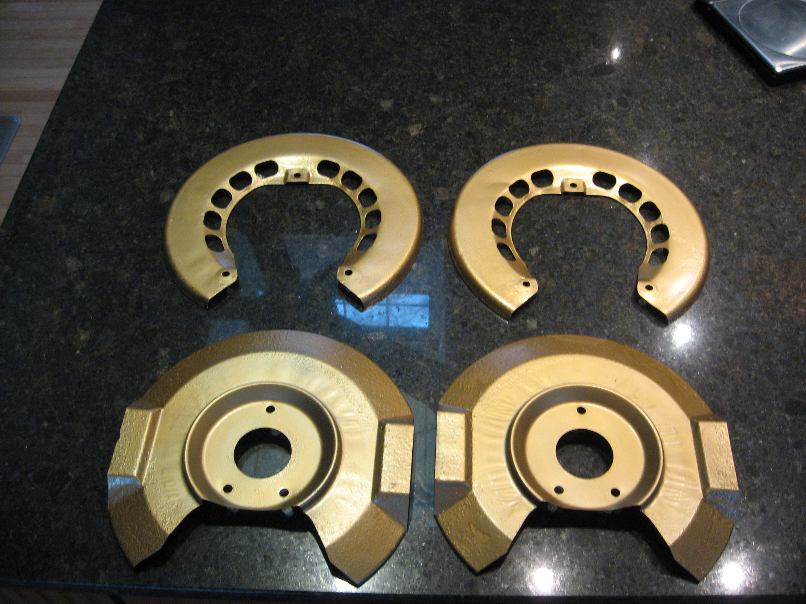

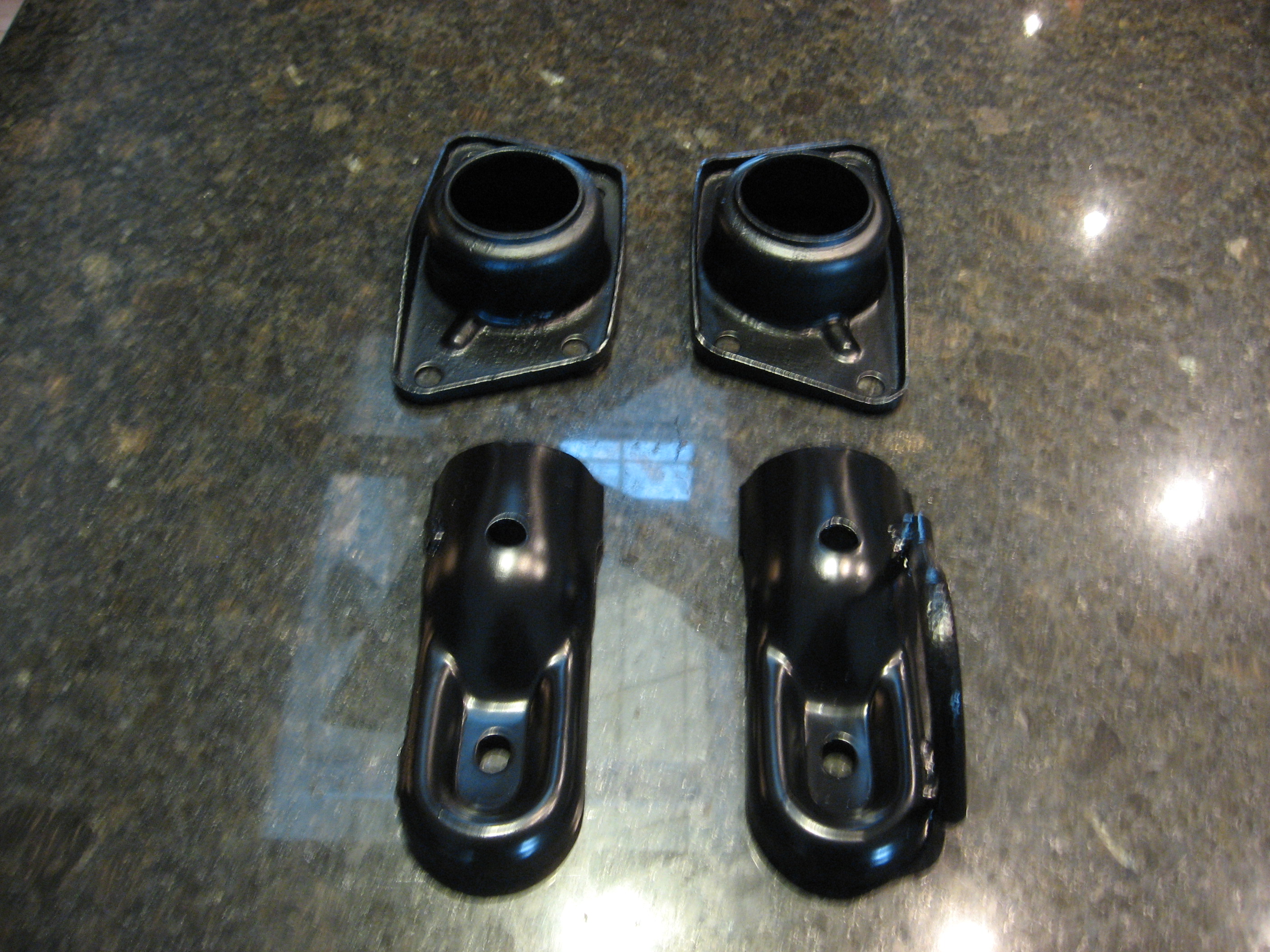

A few more projects completed. Paint is PJ1/VHT engine paint. Heat treated after it cured. Should stand up well. The brake shields were very rusty, cleaned up with wire wheel, cleaned degreased and POR15 like paint, then topcoated with 3 coats of gold engine case paint & baked in oven. Same with suspension parts.
