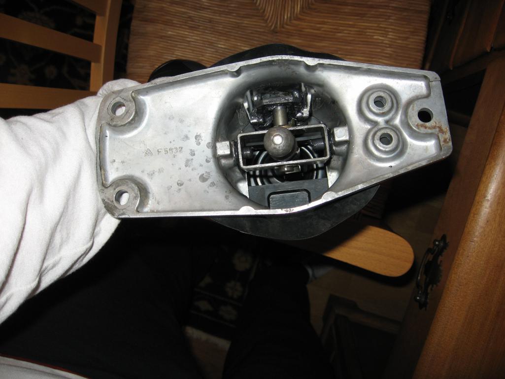

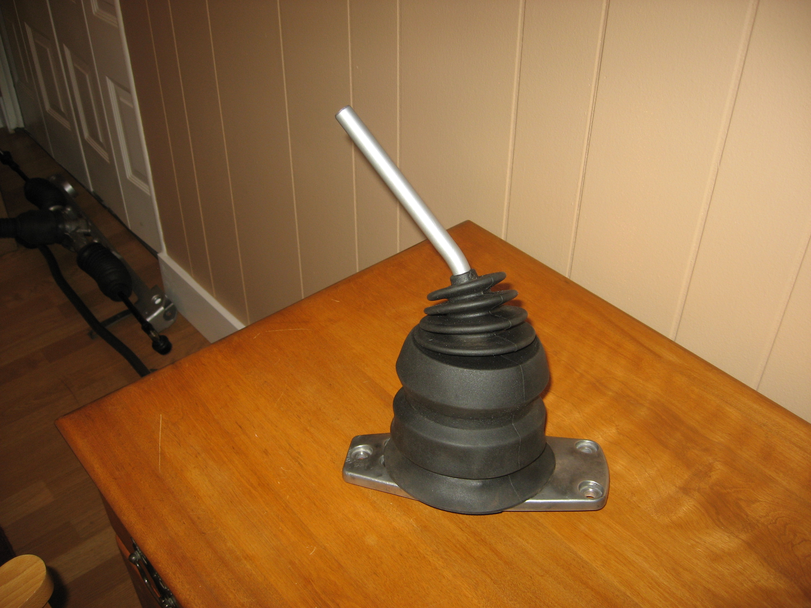

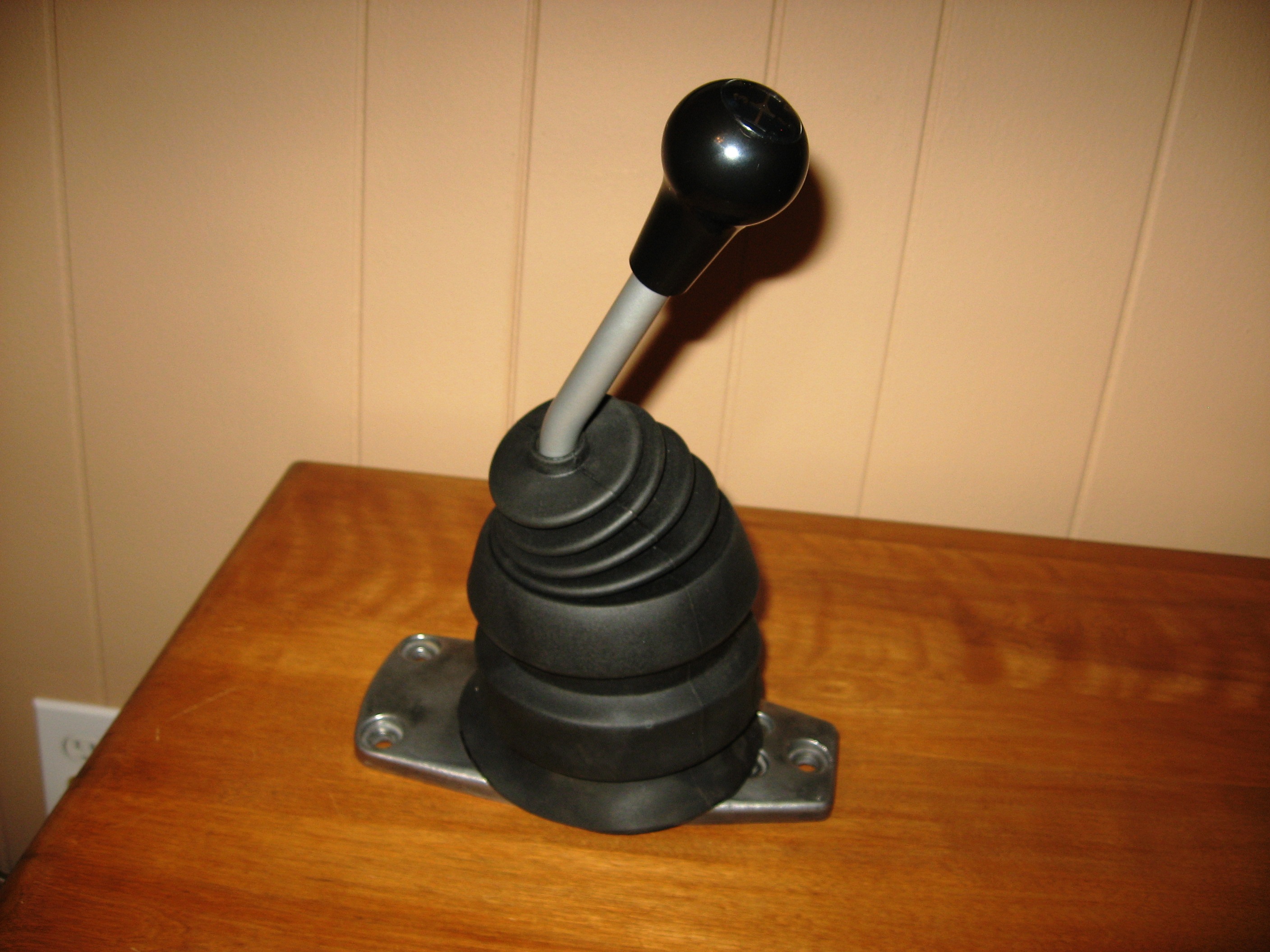

Decided to go silver with the shift lever. Took lever down to metal, then 4 coats of PJ1 engine case paint. Let cure then heat treated. Should stand up well. Waiting on the new shift knob with silver shift pattern, Looks great and matches the Momo Protipo Steering wheel. Dissasembled the unit, cleaned it all up, polished pivot points & reassembled.
