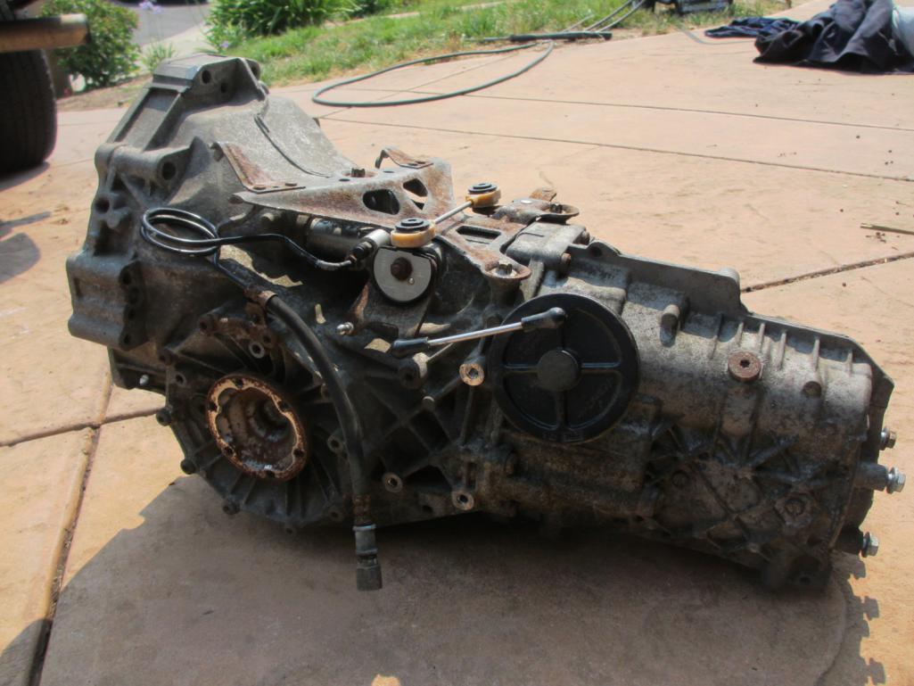

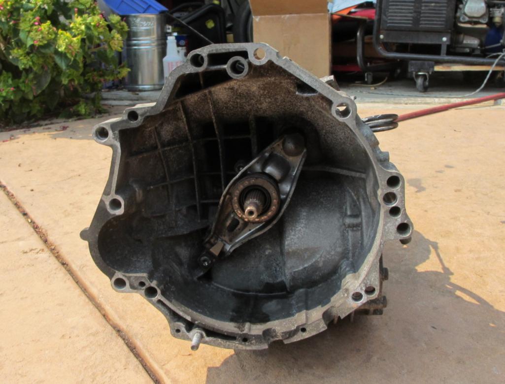

Picked up a Boxster S transmission thanks for the input.
I understand all S Boxster's
transmissions are good to go. Is that correct ???
