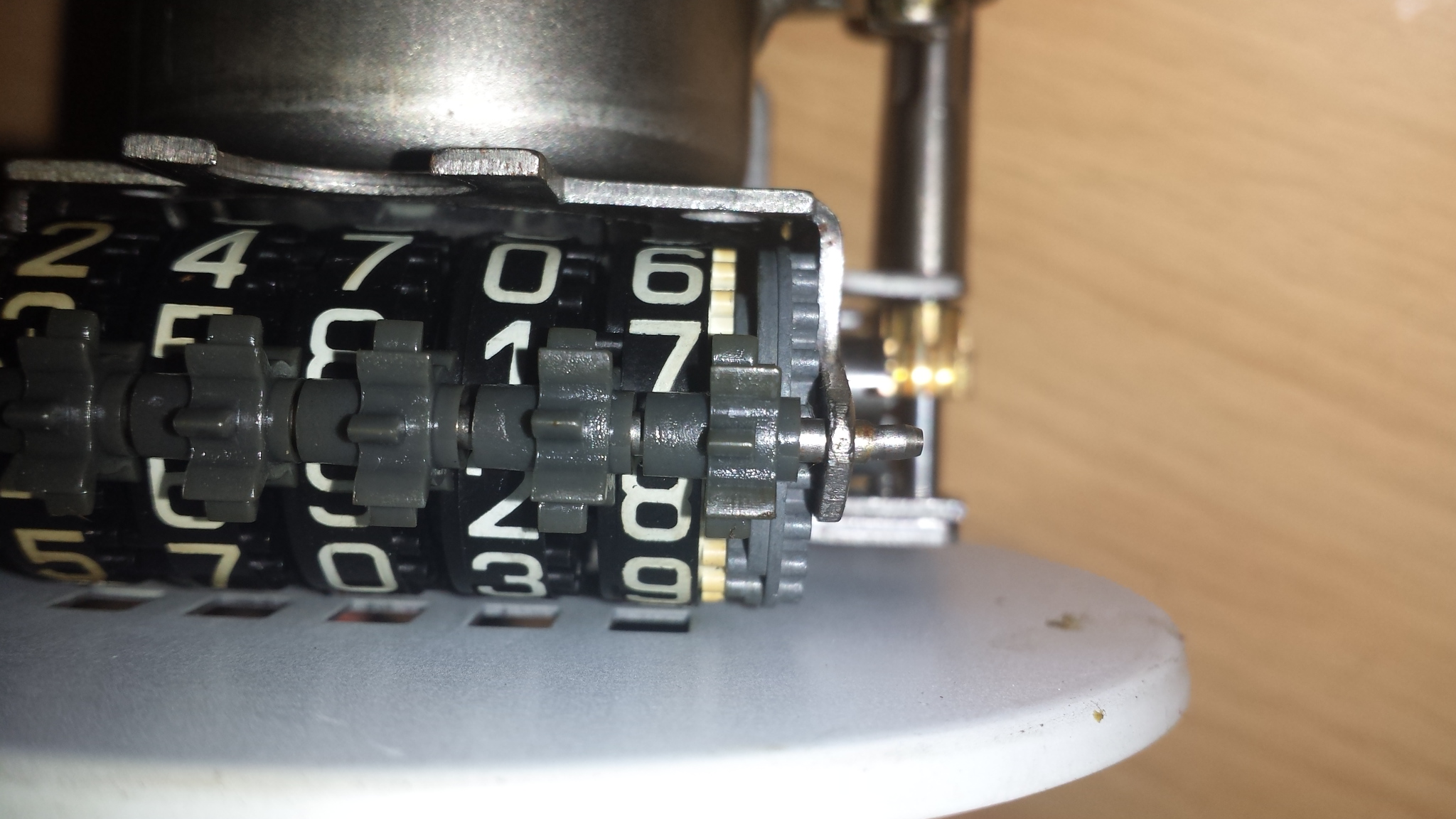

r_towle   Look for this pot metal gear. This is the one that...   Feb 6 2014, 10:10 PM
Dave_Darling   Here's another take on the odometer repair thi...   Feb 6 2014, 10:38 PM
euro911   This is the gear   Feb 6 2014, 11:02 PM
Bob L.   This is the gear That's the one that is ...   Mar 23 2014, 06:30 PM
