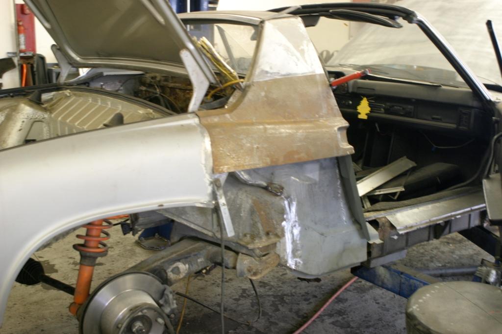

I haven't seen this car in person but the body has some rust. The "hell hole" has been repaired. But I haven't done body work before. I'm a decent mechanic but have never done body work. (although I have drywalled the basement).
Looking over the forum, I know there are other areas to look for rust, but how difficult is this to repair?
Thanks for any help you can give

Looks like you have rust at the lower end of the door jamb also, I would suspect the other sail panel is bad also, and there's likely a whole lot of rust hiding elsewhere.
So if it your not afraid of stuff like this, then go for it, but otherwise plenty of decent cars to be had if you look around for a while.

partwerks   I have a small rust spot on the passenger side als...   Feb 10 2014, 09:36 PM
Ferg   Based just on those two pics, if u can't weld ...   Feb 10 2014, 09:57 PM
Mike Bellis   I've seen better cars that were free... :(   Feb 10 2014, 10:18 PM
KELTY360   It's an iceberg.   Feb 10 2014, 11:36 PM
Dredwin   It's an iceberg. Or is this the Titanic? I...   Feb 11 2014, 12:23 AM
KELTY360   It's an iceberg. Or is this the Titanic? ...   Feb 11 2014, 07:29 AM
worn   [quote name='Dredwin' post='1996322' date='Feb 10...   Feb 11 2014, 09:49 AM
worn   No, you'd be the Titanic if you hit on this ...   Feb 11 2014, 11:21 AM
ConeDodger   Keep looking... :(   Feb 11 2014, 12:21 AM
somd914   Looks like you have rust at the lower end of the d...   Feb 11 2014, 04:56 AM
CptTripps   Yeah...let someone else "save" that one.   Feb 11 2014, 05:01 AM
Chris H.   Yep this is the clincher right here... It...   Feb 11 2014, 07:24 AM
ClayPerrine   Yep this is the clincher right here... It...   Feb 11 2014, 10:24 AM
76-914   This would be a much better start with a little ru...   Feb 11 2014, 09:58 AM
Chris H.   Oh I'm aware it's common for a 914 to rust...   Feb 11 2014, 10:40 AM
rdauenhauer   BTW that's not so much "foam" like t...   Feb 11 2014, 11:04 AM
Dredwin   Thanks for the advice. The guy says is some rust ...   Feb 11 2014, 11:29 AM
KELTY360   Thanks for the advice. The guy says is some rust...   Feb 11 2014, 03:46 PM
ClayPerrine   One suggestion... show up with an ice pick and pok...   Feb 11 2014, 01:09 PM
rdauenhauer   :agree: Best option would be to remove the rocker...   Feb 11 2014, 01:33 PM
Dredwin   Thanks for the advice. The guy says is some rus...   Feb 12 2014, 02:28 AM
CptTripps   :agree: with your decision to "move on" ...   Feb 12 2014, 06:00 AM
KELTY360   My (unsolicited) advice: Go out there with enoug...   Feb 12 2014, 07:31 AM
Dredwin   My (unsolicited) advice: Go out there with enou...   Feb 12 2014, 08:04 PM
CptTripps   Here's the car. http://seattle.craigslist.org...   Feb 12 2014, 08:31 PM
Mikey914   I'm sure the guy has the $2500 into it, t...   Feb 13 2014, 11:20 AM
audio_file   Here's the car. http://seattle.craigslist.or...   Feb 13 2014, 12:07 PM
Mike Bellis   That car is about $10,000 in metal work to re...   Feb 13 2014, 08:51 PM
