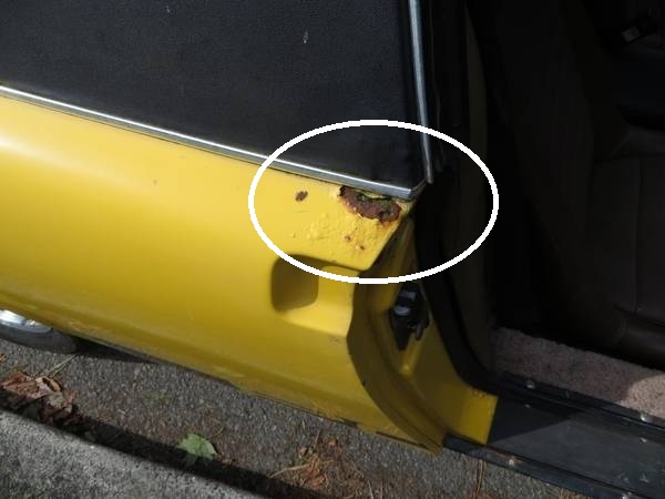

I haven't seen this car in person but the body has some rust. The "hell hole" has been repaired. But I haven't done body work before. I'm a decent mechanic but have never done body work. (although I have drywalled the basement).
Looking over the forum, I know there are other areas to look for rust, but how difficult is this to repair?
Thanks for any help you can give

Yep this is the clincher right here...
It's not really "natural" for rust to form there. It came from the inside out. See how its lumpy under the vinyl? That's more rust bubbles. Some people can fix that easily but it can be very frustrating for a first-time build. You can expect it to be much worse under there.

Ferg   Based just on those two pics, if u can't weld ...   Feb 10 2014, 09:57 PM

somd914   Looks like you have rust at the lower end of the d...   Feb 11 2014, 04:56 AM

Chris H.   Yep this is the clincher right here... It...   Feb 11 2014, 07:24 AM

76-914   This would be a much better start with a little ru...   Feb 11 2014, 09:58 AM
Chris H.   Oh I'm aware it's common for a 914 to rust...   Feb 11 2014, 10:40 AM
rdauenhauer   BTW that's not so much "foam" like t...   Feb 11 2014, 11:04 AM
Dredwin   Thanks for the advice. The guy says is some rust ...   Feb 11 2014, 11:29 AM

ClayPerrine   One suggestion... show up with an ice pick and pok...   Feb 11 2014, 01:09 PM
rdauenhauer   :agree: Best option would be to remove the rocker...   Feb 11 2014, 01:33 PM
