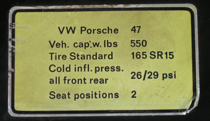

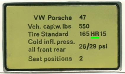

QUOTE(bajafreaks @ Feb 13 2014, 01:26 PM) *
It reads engine size 120 CID
In that case, your tire size should be 165 HR 15, like on the image below. If it says 165 SR 15, that would indicate the 1.8-liter.
2-liter:
1.7, 1.8-liter:
