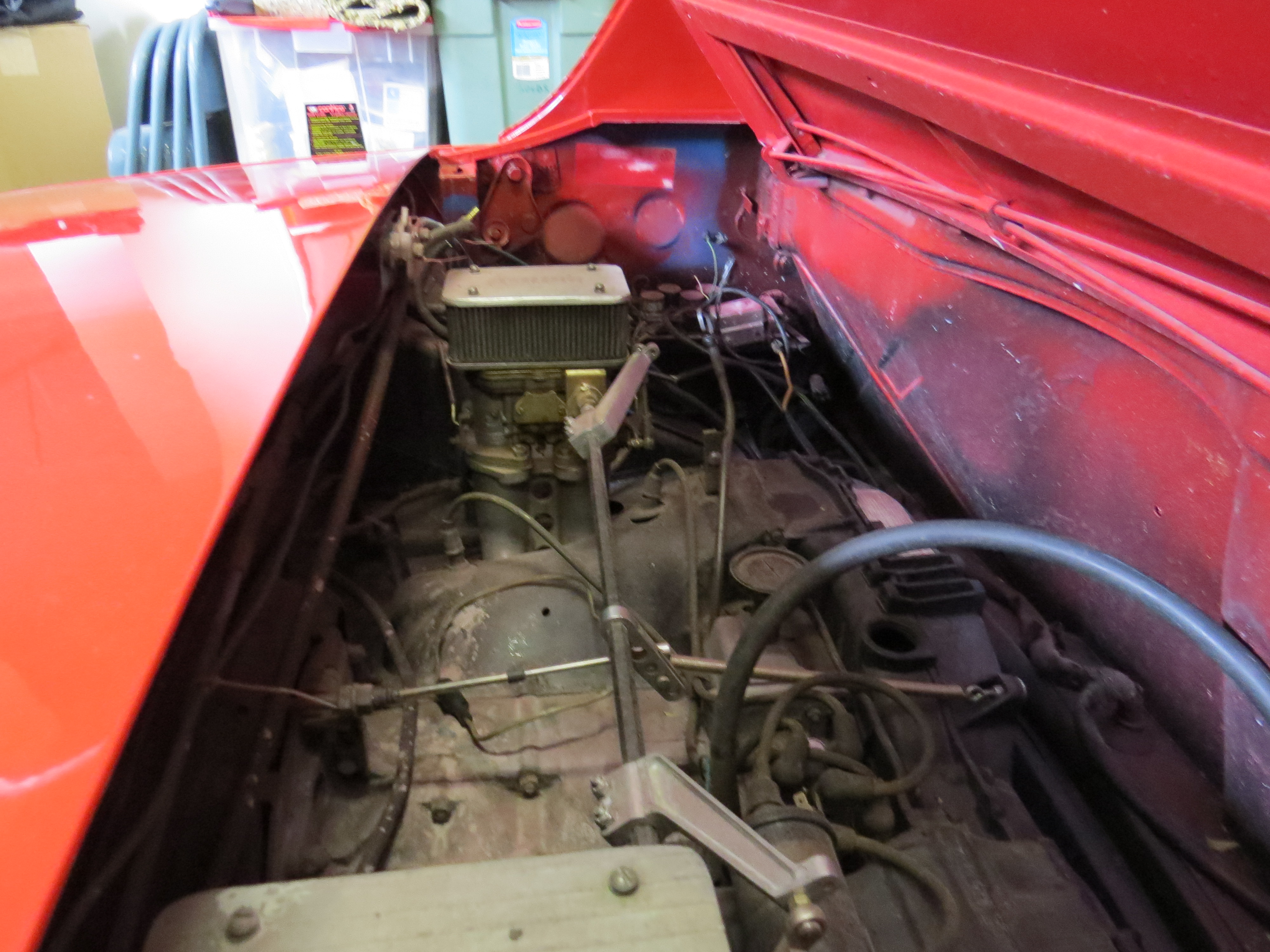

The engine you think you have is substantially different from other Type 4 based engines, and it's unlikely to be in your car. Let's see a picture of the top of the engine .........

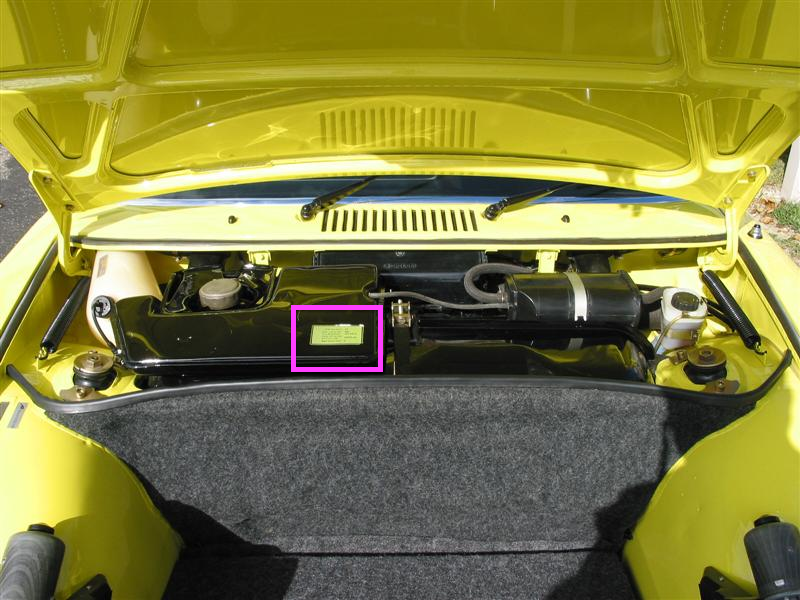

Click to view attachmentSee the red rectangle on the drivers sidewall? Is the emissions sticker under the red paint? Try to clean the sticker carefully, I used brake cleaner, and see what it says.

BTW, what's up with that carb linkage? I think I see 2 bars leading to the left and right and an eye hook on the right side. The one to the right might be the return spring.

The previous owner did some weird stuff the linkage is a little strange I would like to convert it back to F.I. it didn't come with the rear emblems. Apparently the engine was just freshly rebuilt but the car hasn't ran in 10 years. It has later model 75-76 heat exchangers, not sure which transmission yet. Just a mix/match of different year parts and pieces the guy has 3 914's and made one good one out of the 3.
I'm thinking I will try and get it running and take it from there, not sure if I'll leave the bus engine in it or try and find a 2.0. I've defiantly got some work ahead of me but that's okay that's why I bought it. I also got a bunch of extra parts with the deal which I will sell off for cash flow.

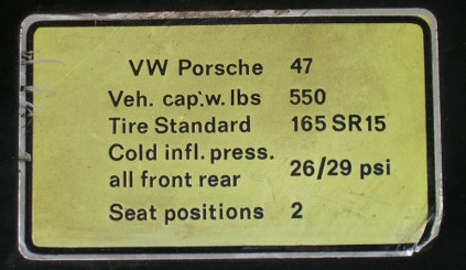

Do you know if your car has its original gas tank? If so, what is the tire size indicated on the label (see below)? 165 HR 15 was spec'd for 2-liter cars.

It is, indeed, a Vanagon motor. Prone to meltdowns when the EGR system is disabled. In this case, removed. Probably be OK with carbs, probably not with FI. How do you add oil? Vanagons used a lower block mounted oil filler unit, which would interfere with the alternator and the tin. I see they solved the dipstick issue with that contraption sticking way up in the middle of the engine compartment. Interesting ...................

Click to view attachmentJust went out and looked it says 165 R 15 so I guess its safe to assume it came with a 2.0 ?

I believe that the 1.8s also came with that size. The 155s were only used on the "base model" 1.7s in the first couple of years, running on 4.5" steel wheels.
The over-painted sticker in the engine bay is the best way to tell without sending the VIN off to Porsche. (With some money, of course!)
The "1.8" and "2.0" emblems were used in 74, but they are trivially easy to remove and replace. I know more than one person who bought a 74 "2.0" that had a stock 1.8 liter motor...
[/quote]
It reads engine size 120 CID

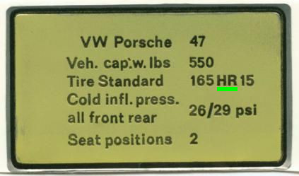

QUOTE(bajafreaks @ Feb 13 2014, 01:26 PM)
In that case, your tire size should be 165 HR 15, like on the image below. If it says 165 SR 15, that would indicate the 1.8-liter.
2-liter:
Click to view attachment 1.7, 1.8-liter:

Click to view attachmentits says 165 HR 15 so I guess we now can say its a 2.0 car.
Thanks for the help guys.
