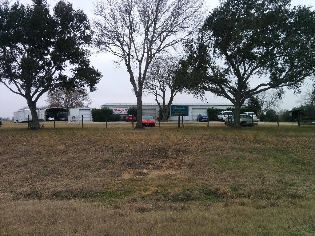

Motor is being rebuiltby Mike Callas. Getting Carrera tensioner upgrade, 911 oil pump upgrade, can rework, new P&C 81mm Stock 8.6:1 compression from JE, and the usual parts like ramps, chains, galleys, bearings, hardware, and the like. Time Serts and Case Savers are not necessary, and this was only 110 hp anyways.

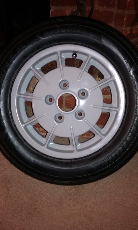

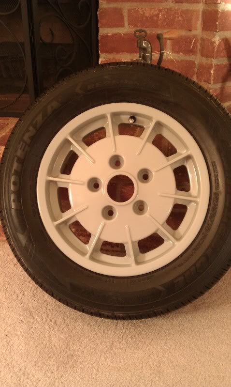

I would have like to rebuild it all myself, but I put off the time and finances were allocated elsewhere. This goes for the Webers as well.

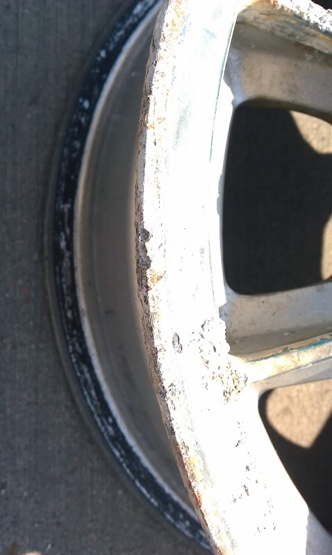

The Gasburners were in pretty bad shape. Last year, I got the magnesium properly rewelded and then powdercoated for good measure. New rubber performance summer tires were then mounted and balanced.
