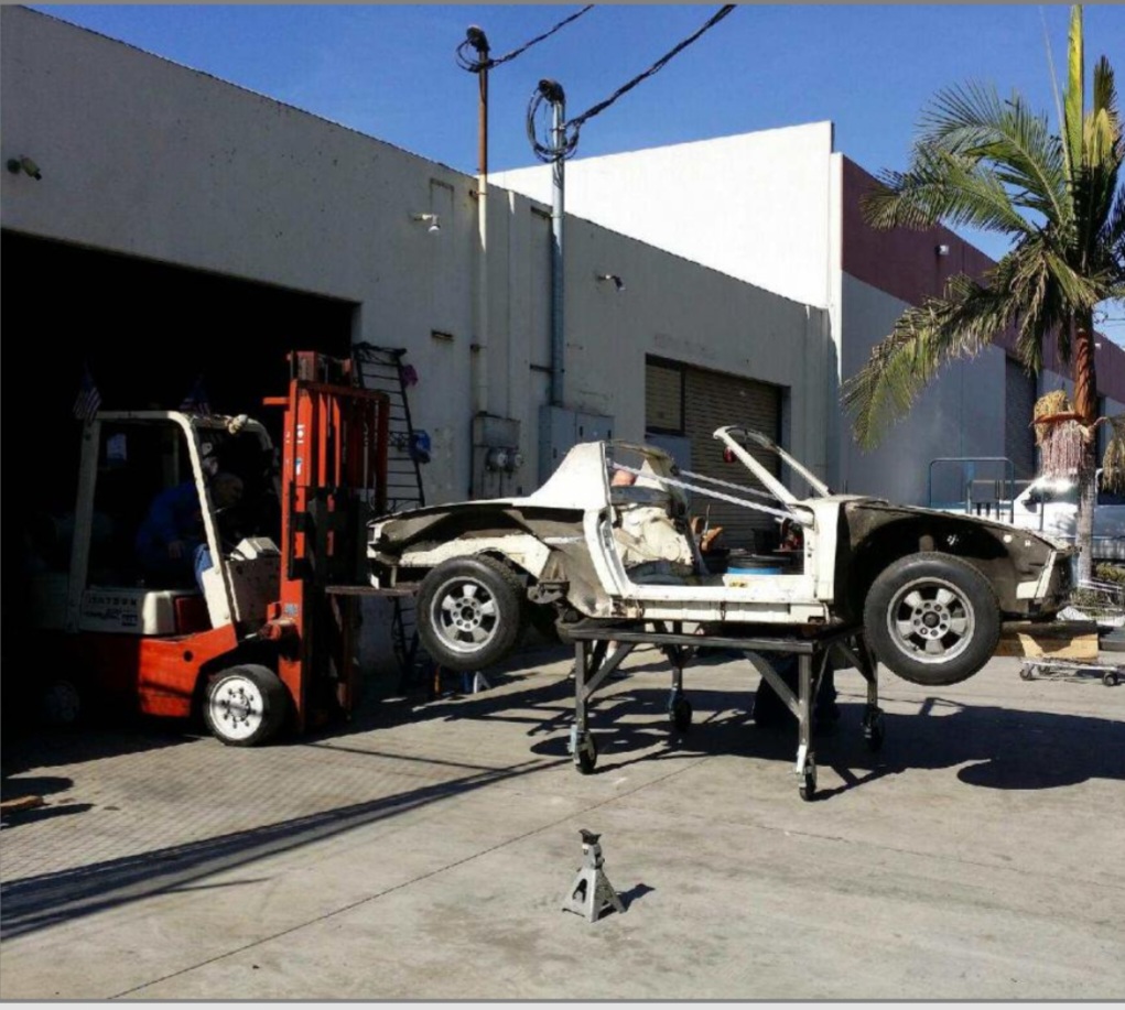

Two forklifts in unison placing the roller onto the dolly...

Maltese Falcon   Two forklifts in unison placing the roller onto th...   Feb 15 2014, 03:29 PM
