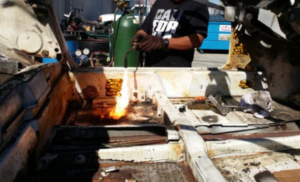

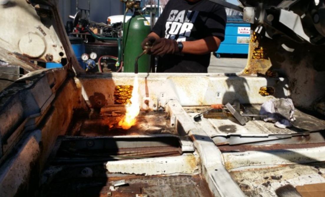

Removing the tar off the floorboards, heading out to the media blaster...then back to MSDS for more action.

Maltese Falcon   Removing the tar off the floorboards, heading out ...   Feb 15 2014, 03:35 PM
