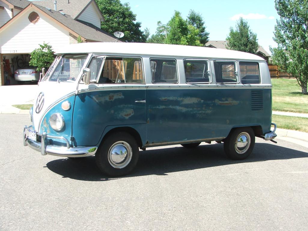

Well I did get the hardware back, but it was never plated. Anyone have a good source for yellow zinc plating in Northern Colorado? (Fort Collins area)
Not much update on the body. It is in primer though, and the driver's door is getting re-skinned.
While waiting I've been working on my other project.
http://www.thesamba.com/vw/forum/viewtopic.php?t=565585
