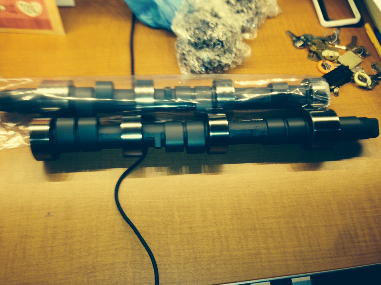

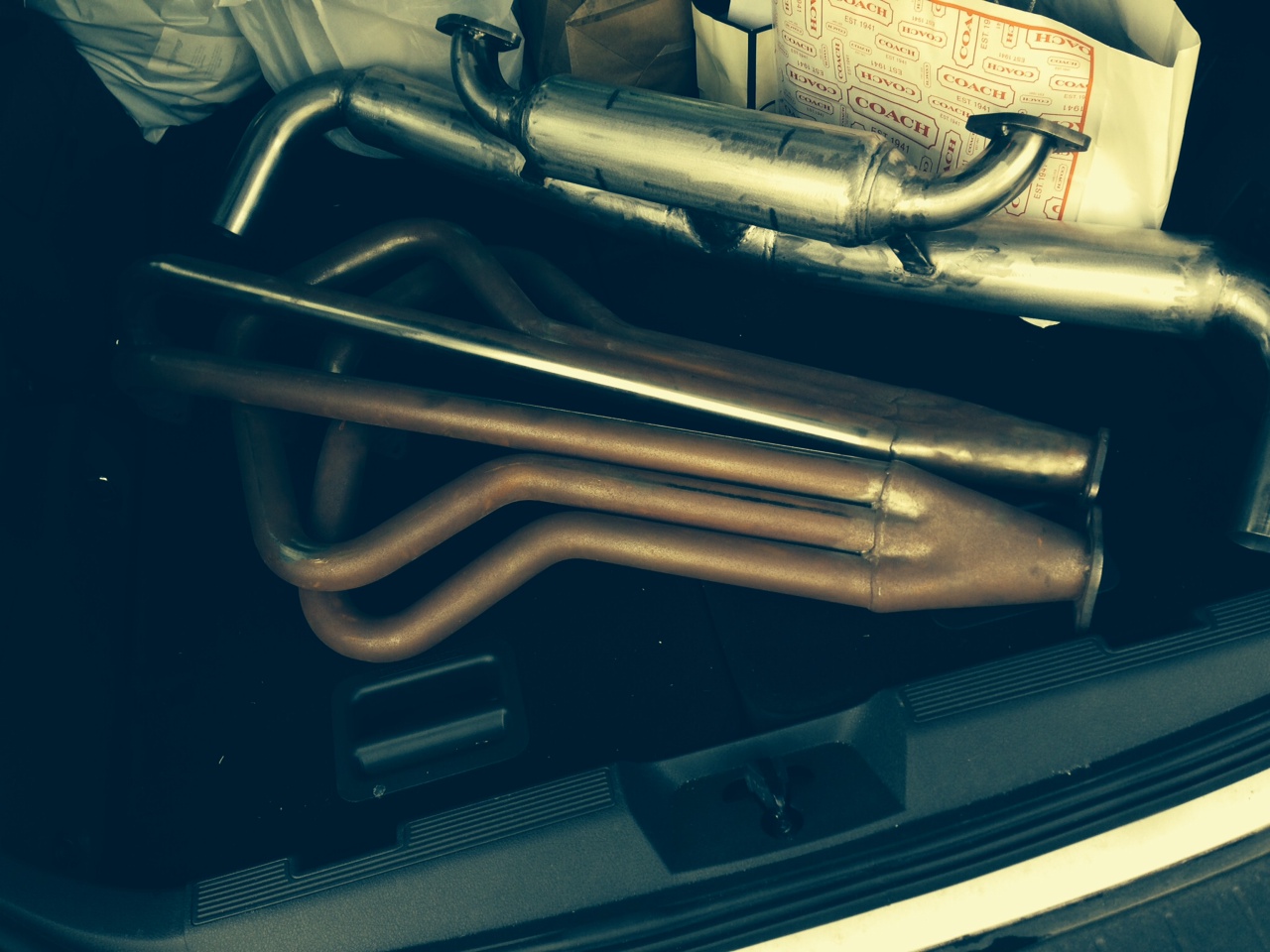

Today I stopped at Triad to pick up my headers and muffler. I dropped them off on the way home to be ceramic coated a gloss silver. When I got to the front door, I found my cams!
