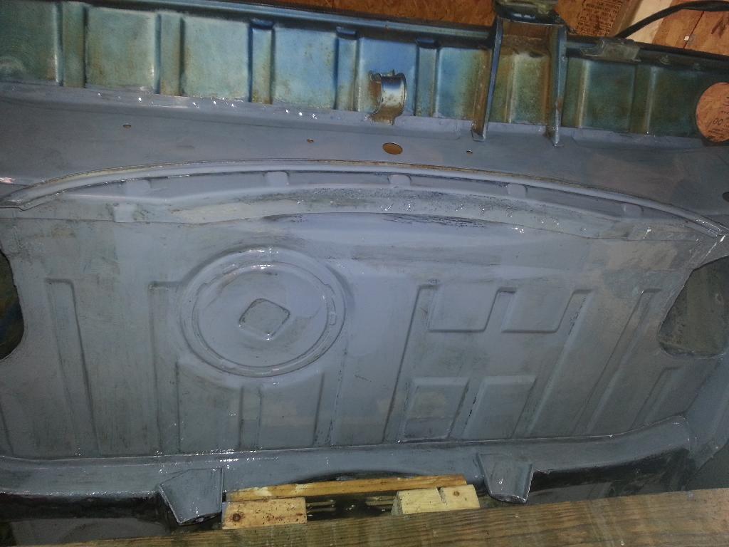

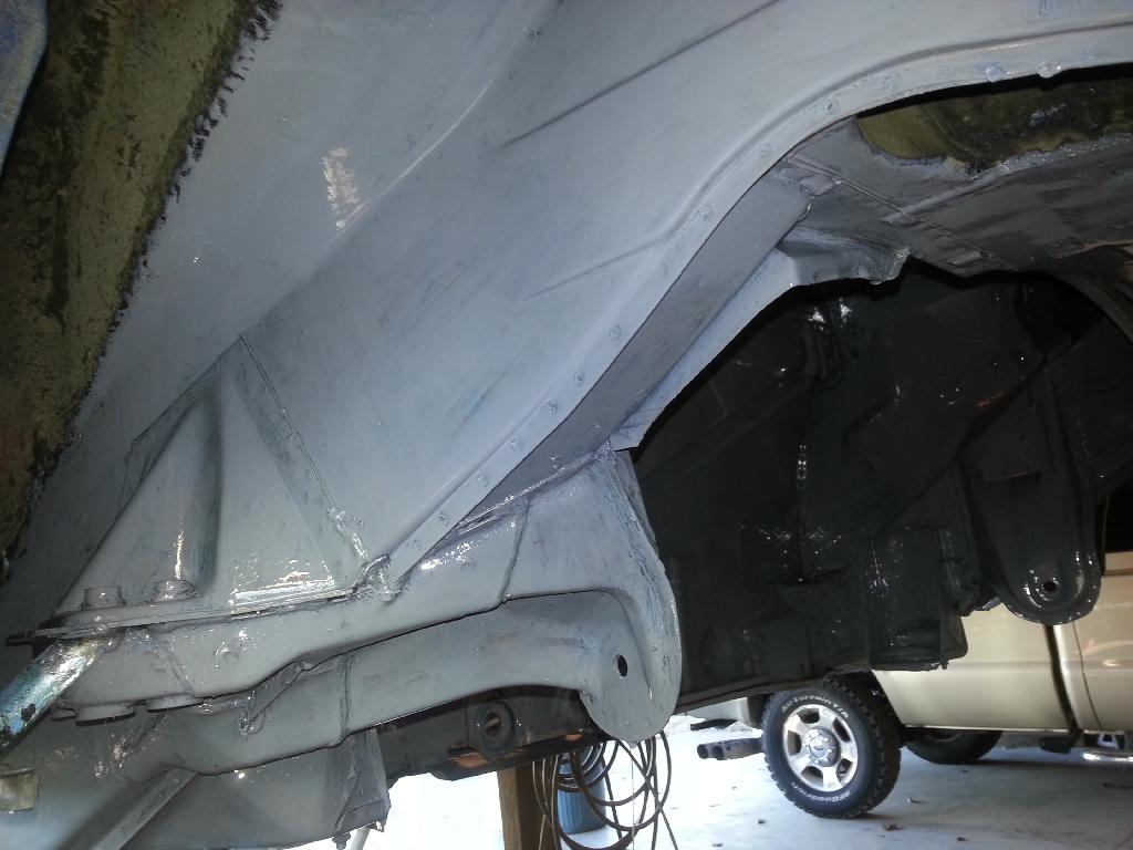

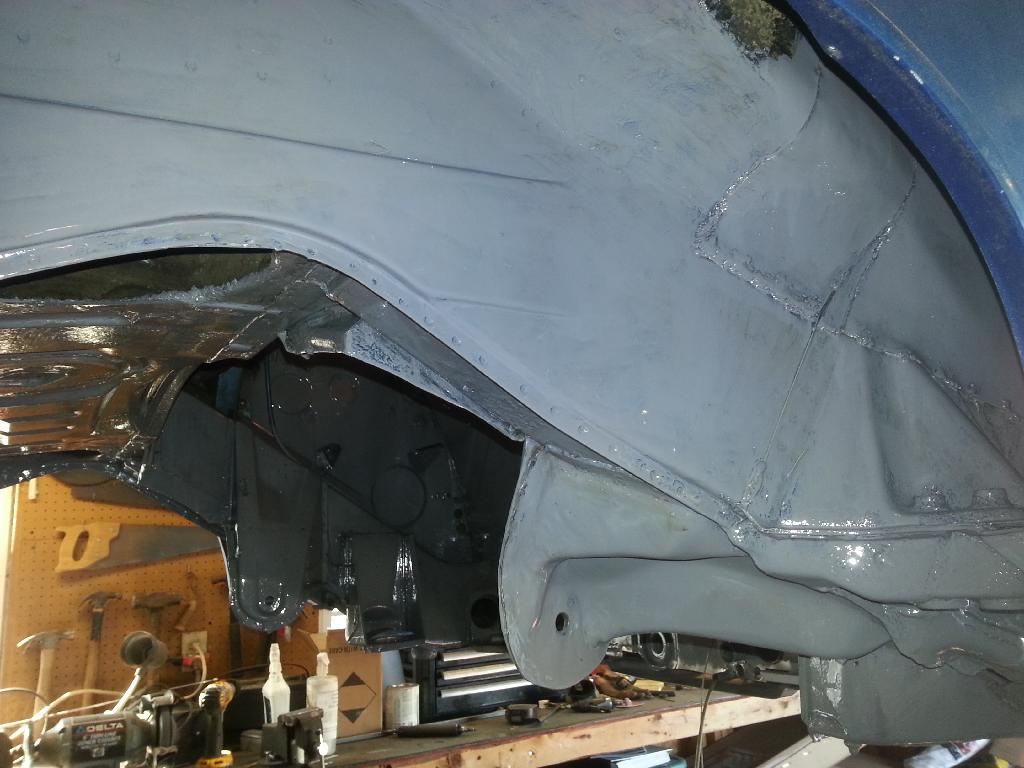

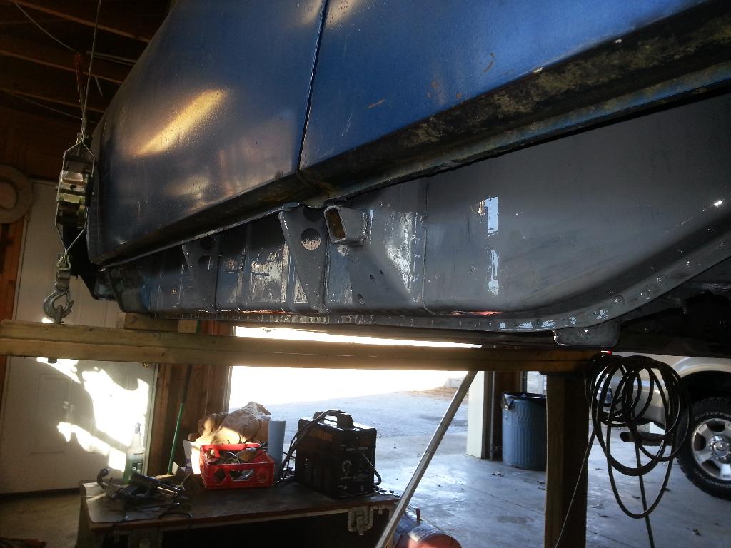

Before I lower the car, strip and treat the gas tank compartment - I decided to treat the under-side of the rear trunk pan, rear wheel houses an drivers side outer long. So about three hours wire brushing, scraping and cleaning. The POR 15 goes on well and I'm feeling like the more of this metal I get covered - the better. Once the POR 15 sets up - I'll lower the car, reposition the lifting beams and take care of the "pit".
