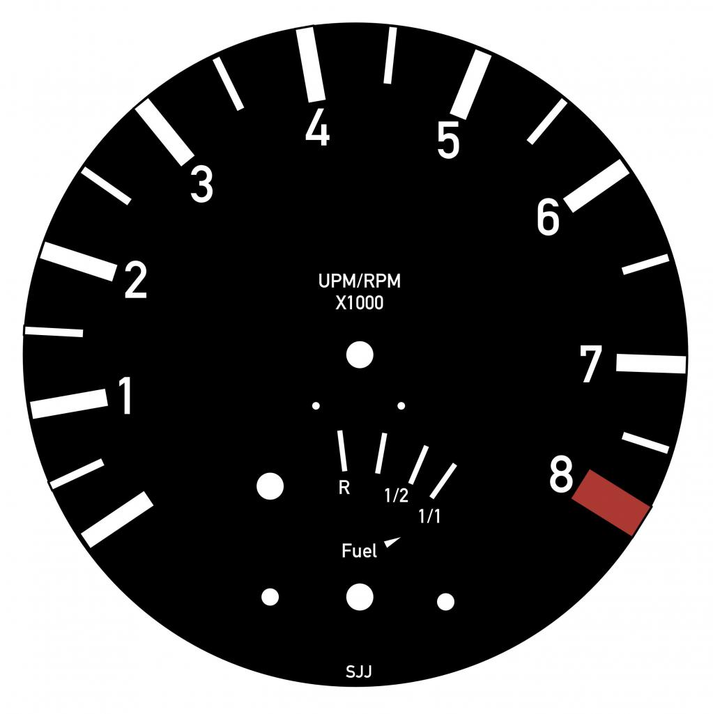

Okay, for my project I have been working on a concept to build a custom set of gauges to keep every thing in the dash. And I am thinking about building some kits so you can build a set yourself.
First off is a Tach with a fuel gauge at the bottom, in reality it could be anything with a 90 degree sweep. So Turbo boast ala 930, but my is getting a fuel gauge. It is setup to use the Sun Tach update and the mounts have been moved to make it work. It will look something like this when its done. The tach needle will be the proper length once done, I need some pin drills.

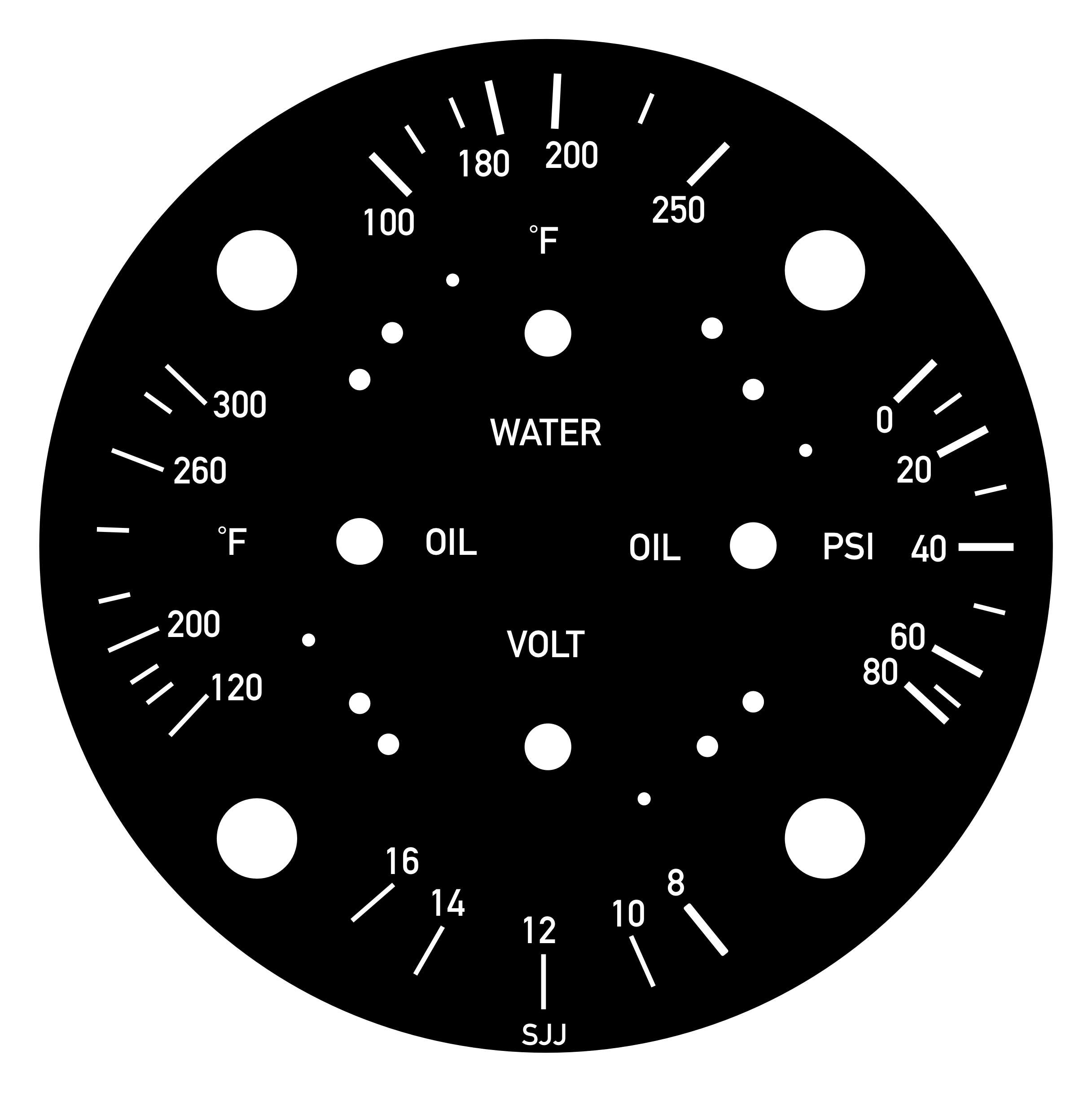

The quad gauges I setup for Oil pressure and temp, water temp, and volts.
I need to clean up some of the line widths on this one call it an alfa as I used it to prototype with. Even though CAD said it would work, and it did, I liked hold a down and dirty physical version in my hands. Nothing like a laser printer and a few pieces of cardboard.

Tach and Fuel Combo
The Quad Gauge

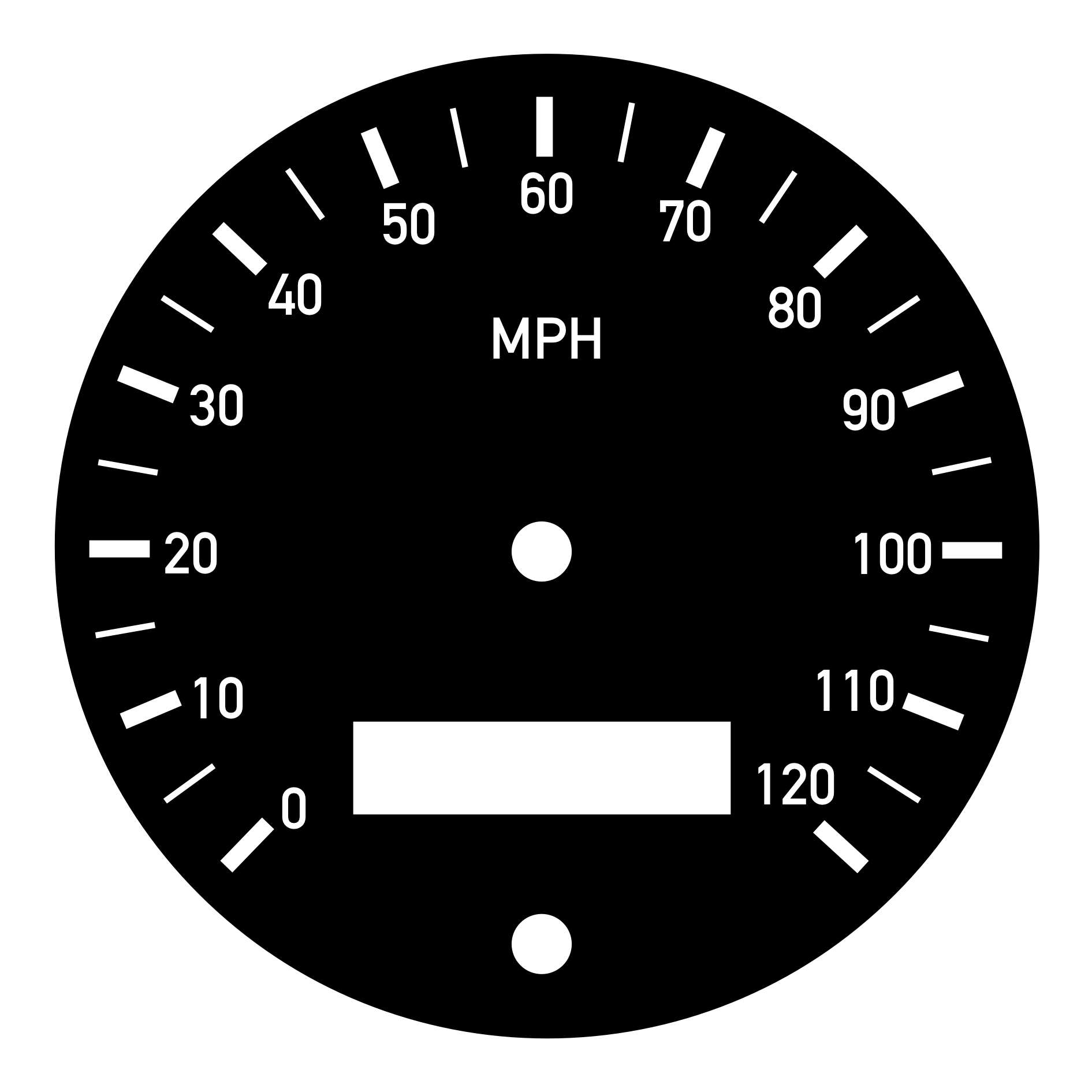

And last but not least the face for my Speedo, it is a smaller VDO cockpit version I needed to match the fonts on.

914forme   Okay so I messed with the fonts today, this is as ...   Feb 17 2014, 04:08 PM
CptTripps   First up Tach and Fuel Combo Gauge. To me, tha...   Feb 18 2014, 07:42 AM
914forme   First up Tach and Fuel Combo Gauge. To me, th...   Feb 18 2014, 09:52 AM
CptTripps   Okay Doug, what program did you use to do that? ...   Feb 18 2014, 12:01 PM
