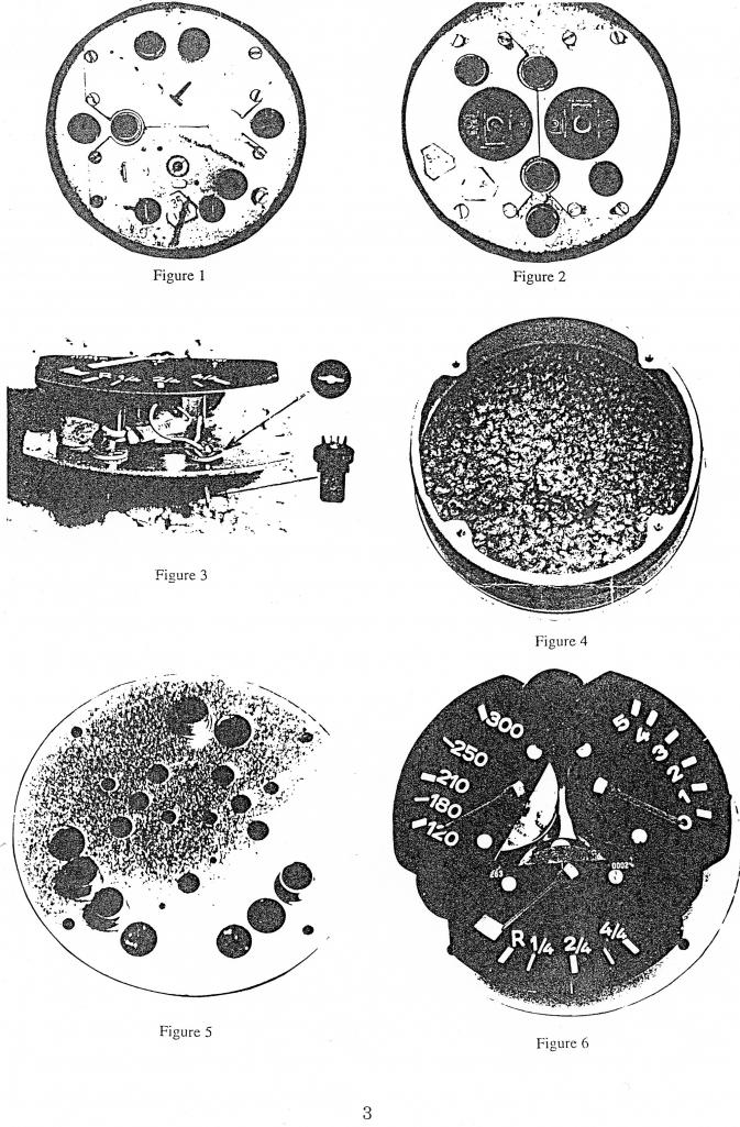

Here is the pictures used as reference in the instructions.

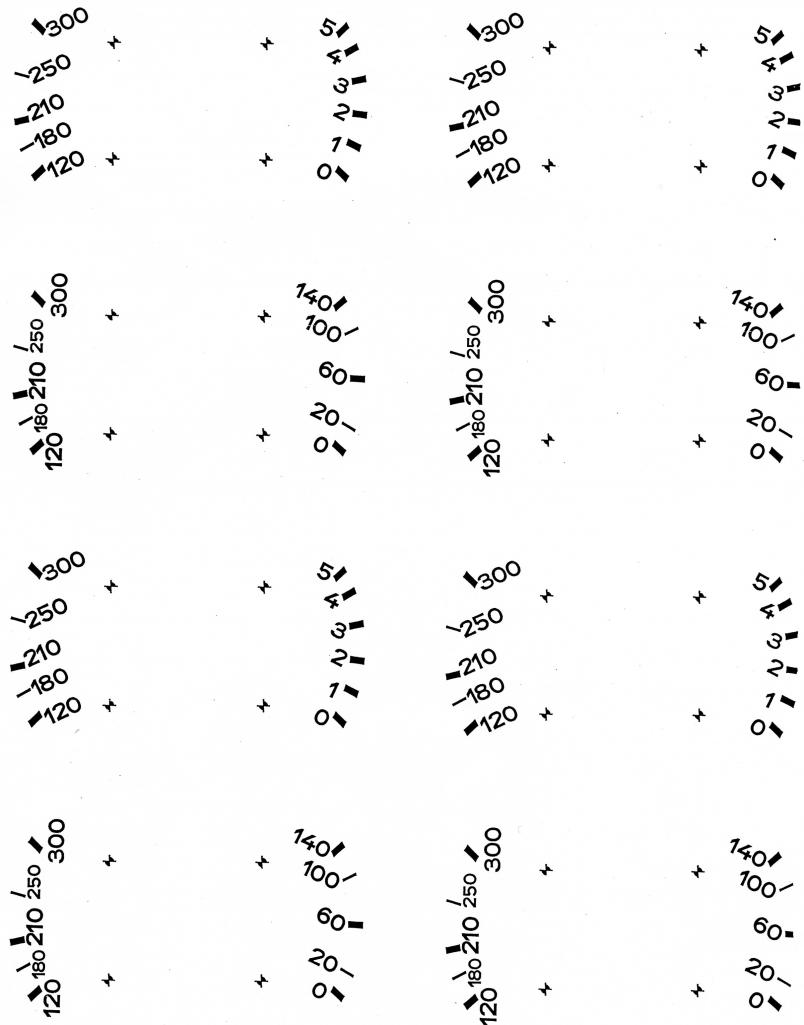

And here is the art work to print the gauge faces themselves in proper letter orientation.

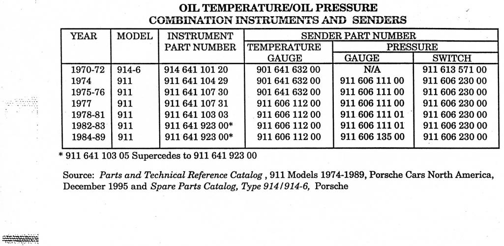

And the cross reference of gauges to senders:
I hope this helps someone out there.
