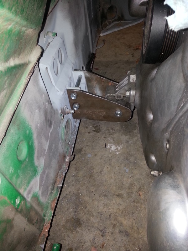

Got a few more hours in yesterday. Re-installed the engine (I'm starting to get the feeling that I'll be very good at this soon), finished drilling the holes for the front engine mount plates and even got the nutserts installed for the fuel pump.
Here's the front engine mount. Only thing left here to do is trim down excess metal and paint!

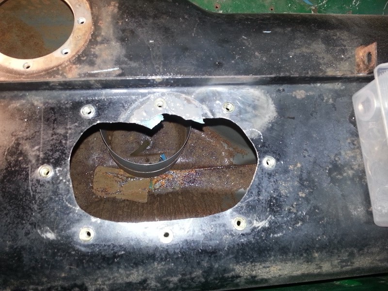

Nutserts for the fuel pump. It looks a bit messy right now on the top side since I used the extra epoxy to fill in holes left by the original fuel sender. Tonight I should be able to remove the tape I used as a backing material and sand it all down nice and smooth. I probably would have been OK welding it (It's been empty for 4+ years), but I just didn't feel like trying it alone at 11 PM without a fire extinguisher. Since the holes are all located where the gasket material covers this is more for good measure anyways. This pic really brings out the "patina" inside my gas tank!
