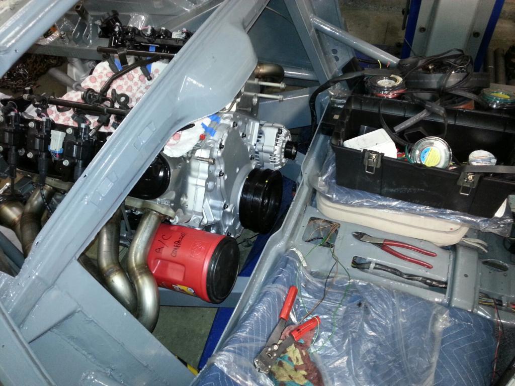

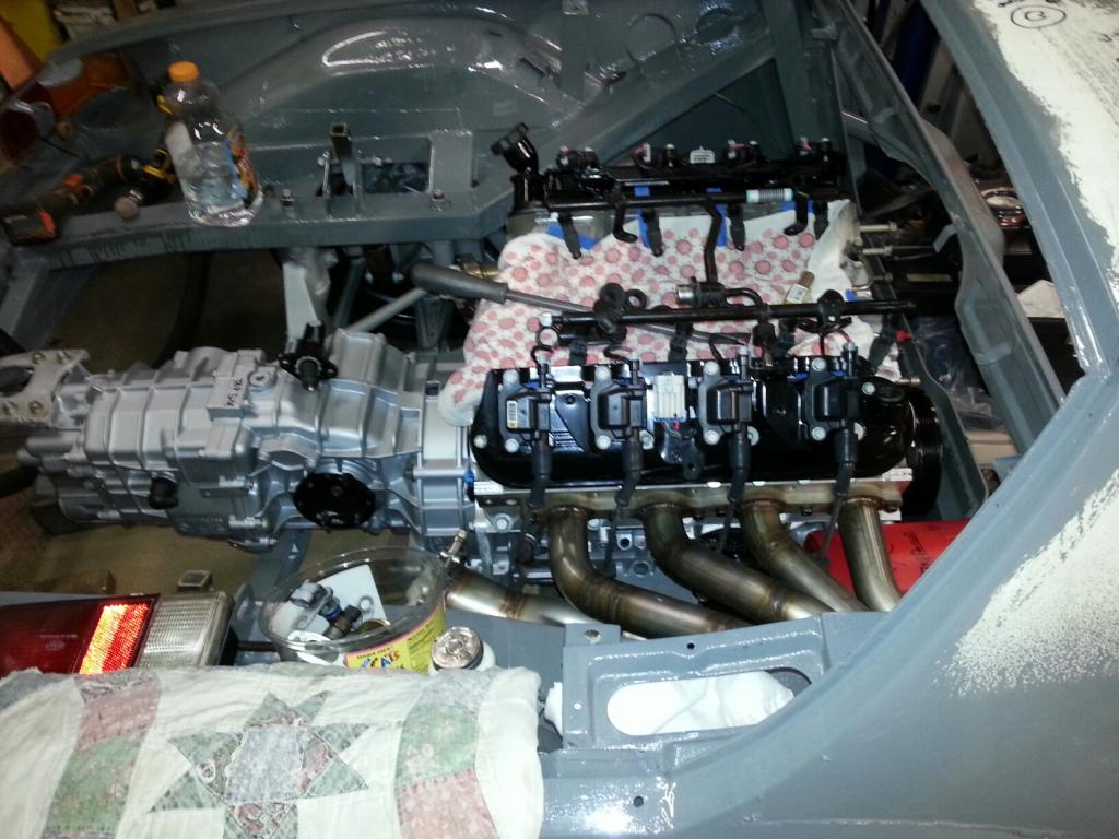

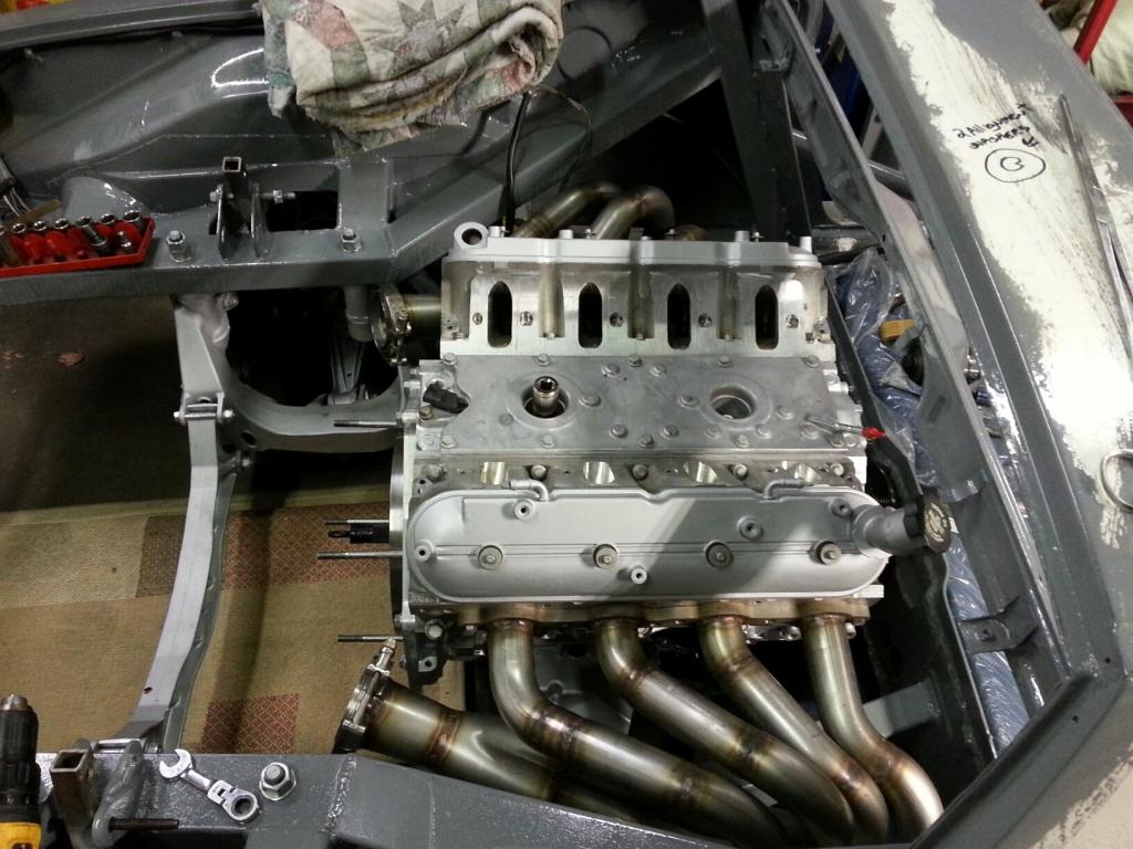

Putting things together, still have some parts to buy
(IMG:http://www.914world.com/bbs2/uploads_offsite/i60.photobucket.com-3782-1393389226.1.jpg)
(IMG:http://www.914world.com/bbs2/uploads_offsite/i60.photobucket.com-3782-1393389226.2.jpg)
(IMG:http://www.914world.com/bbs2/uploads_offsite/i60.photobucket.com-3782-1393389226.3.jpg)
