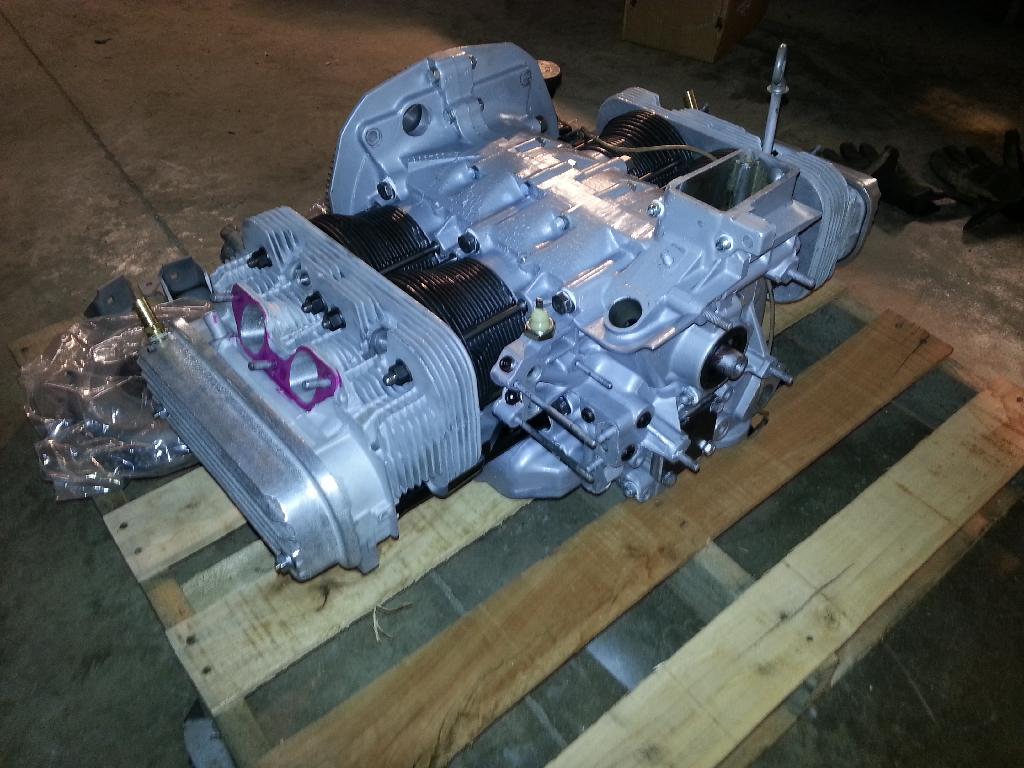

I got the car re-hung last Sunday and started prep'ing the gas tank "pit". That will take a while to get down to bare metal. But a nice little surprise Tuesday. The long block arrived and I picked it up yesterday morning. It sure looks nice and tiddy I just inspected everything and wrapped it back up. It will be awhile before I'm ready to bench test that joker.
(IMG:http://www.914world.com/bbs2/uploads_offsite/i1336.photobucket.com-16456-1393524260.1.jpg)
(IMG:http://www.914world.com/bbs2/uploads_offsite/i1336.photobucket.com-16456-1393524260.2.jpg)
