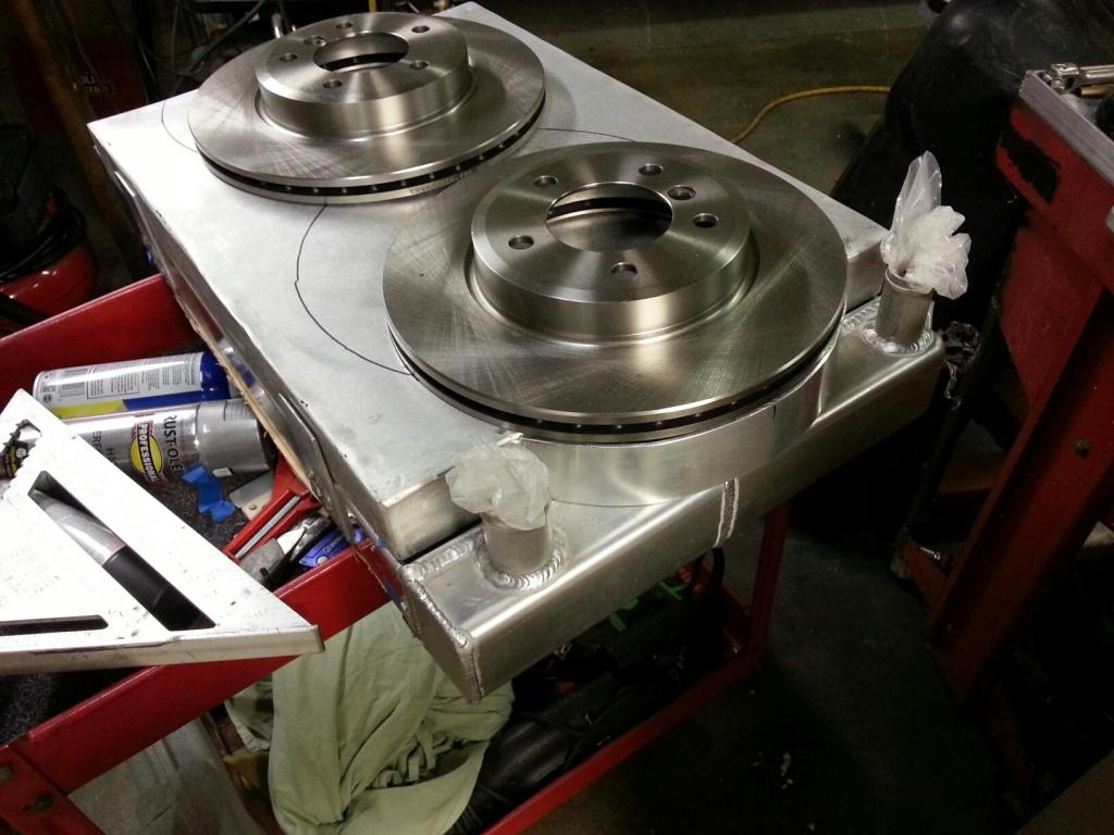

Working on things here and there, here is a fan shroud I built. Its going on a double-Pass radiator. The fans are going to be 2 (12") Spal units for a total of just over 6,000 cfm. I read that and still don't think its a correct rating but I'm going to call Spal and see what they say.
(IMG:http://www.914world.com/bbs2/uploads_offsite/i60.photobucket.com-3782-1393651388.1.jpg)

QUOTE(drive-ability @ Feb 28 2014, 09:23 PM) *
I agree, I dont think 6k cfm is correct.
Their web site shows the best 12" fan they have as 1640cfm
https://webstore.spalusa.com/content/files/...5_2038_SPEC.pdf
However that still looks like a killer radiator setup.
