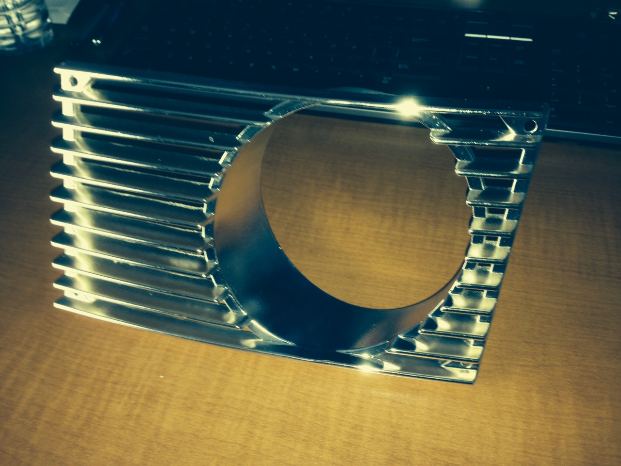

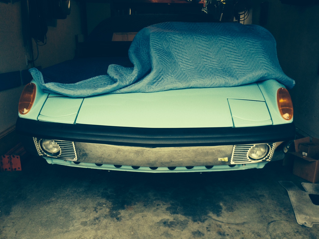

Got the re-chromed fog light grills back and mounted. Used the specrachrome paint process on them and it works
Having a hell of a time with the locks for the targa top. After I got them installed, one of the c clips popped off. Everything still works, so I think I'm going to leave it for now. To access the clip I need to pull the pad off the top of the targa bar again and that's a pain. It will be a good job to do next winter when its too wet to drive the car.
