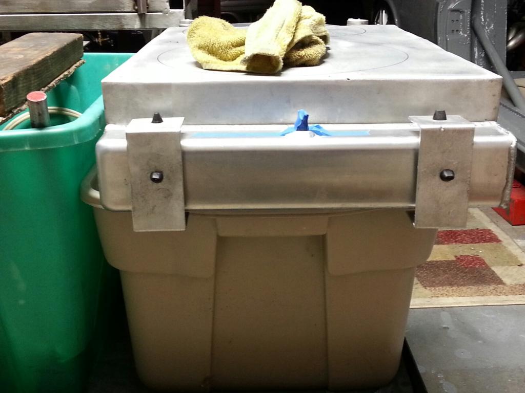

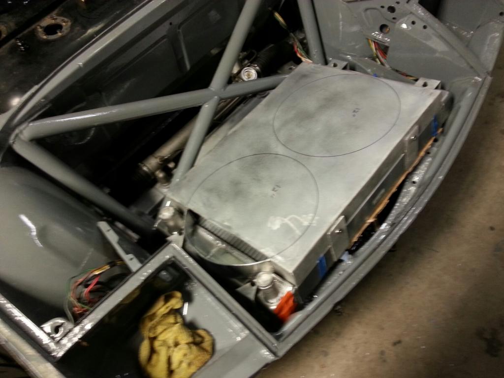

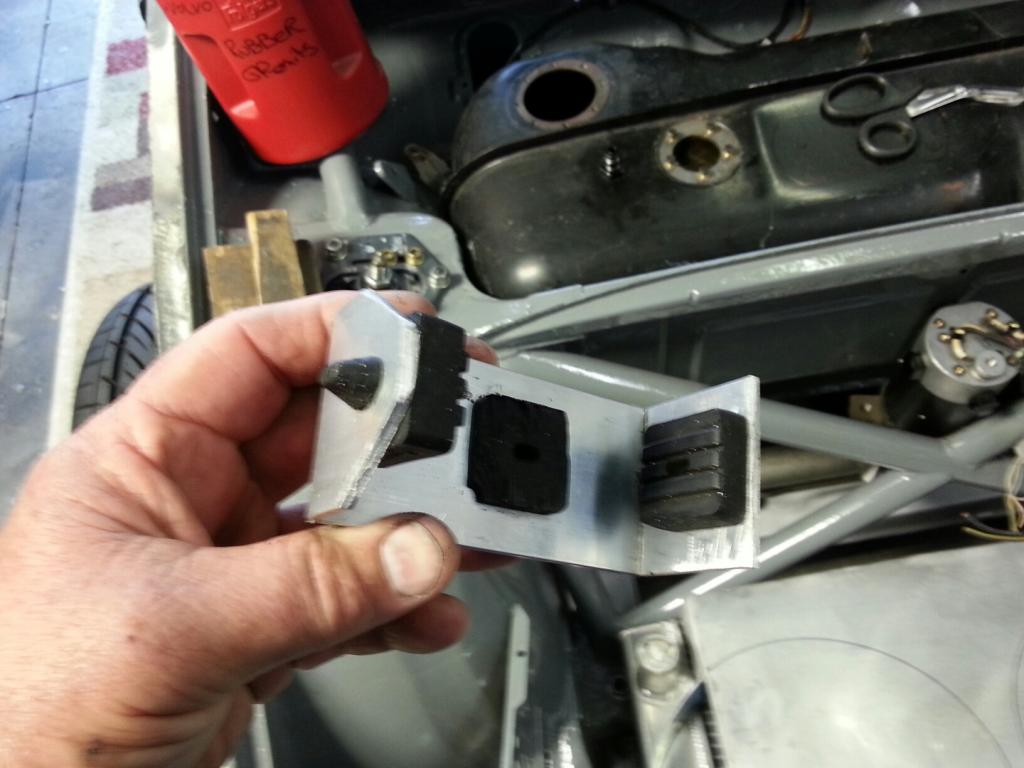

I just picked up 2, 12 inch fans and as we suspected the 3k cfm was an incorrect value. I bought Spal # 30103202 which are rated at 1800 cfm each. That rating is a general value based on zero drag so to speak. I shopped around and found them as high as $225 each but found them on line at THMotorsports for $150 each. Expensive units for sure but Spal are quality parts. Running as mentioned before using a 2 speed system is a great idea. Low speed fans are much quieter for sure.
Having the support braces welded in make it a bit harder to fit the radiator. I ended up making my radiator shroud and insolated mounts. Below is a few pictures.
