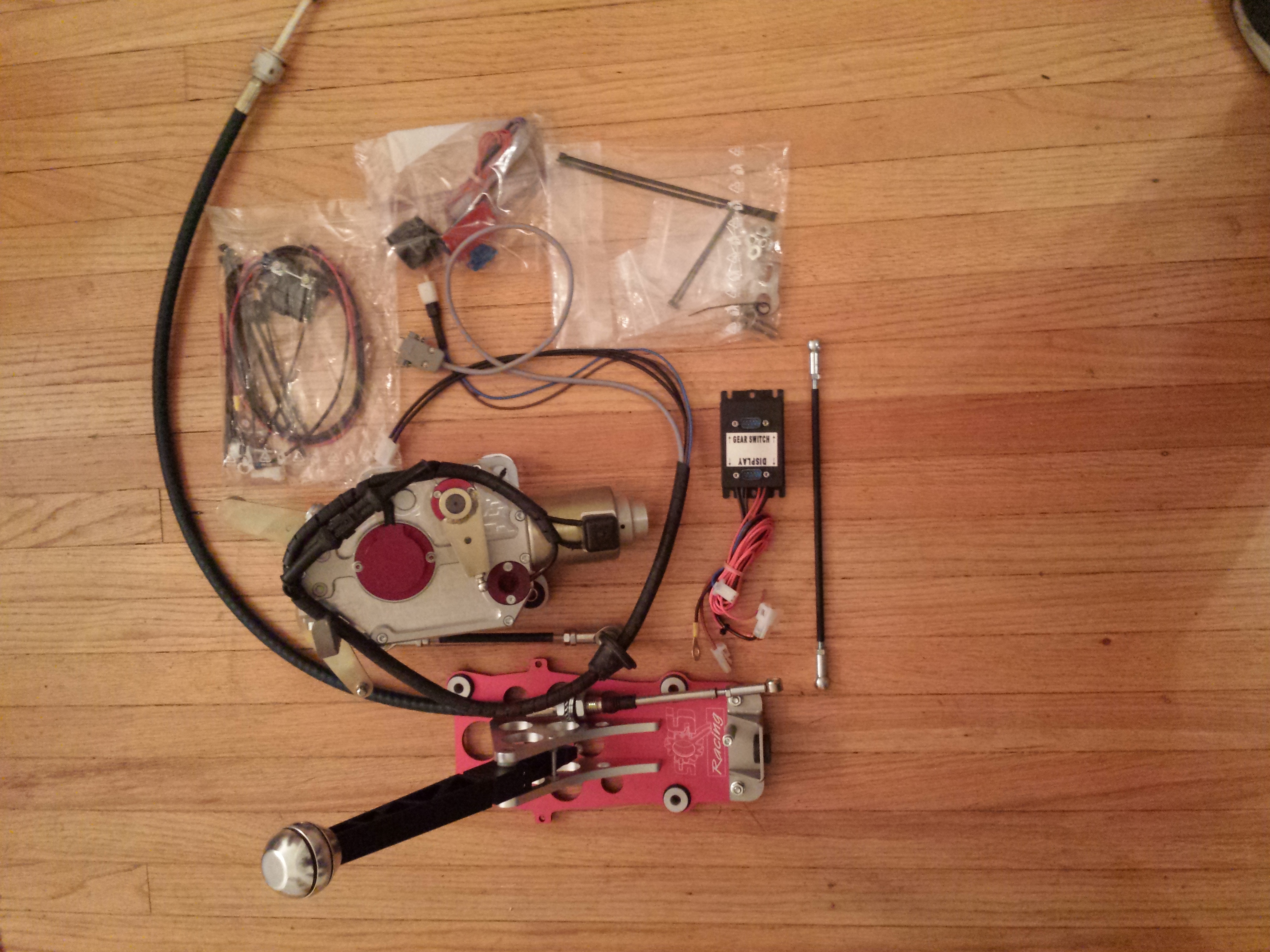

SQS sequential shifter system for the 996gt2 transaxle.
We will need to have a longer cable made for mid engine application. Attached Image

Maltese Falcon   SQS sequential shifter system for the 996gt2 trans...   Mar 7 2014, 11:44 PM
Maltese Falcon   SQS, sequential 6 speed shifter mechanism.   Mar 7 2014, 11:55 PM
