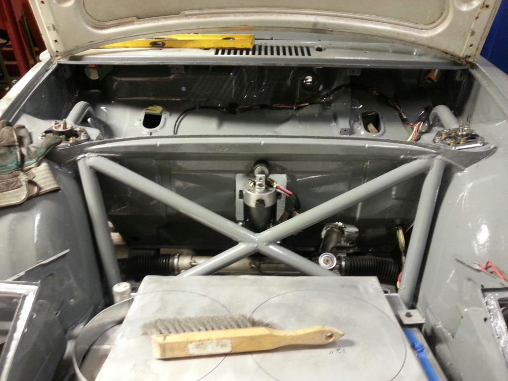

Waiting for my cooling fans to arrive so I mounted the Toyota MR2 electric power steering pump. I used the same pump in my (sold) V8 914 and it worked great. In this case the steering system was built by German engineers (996) not by me in my 1 car garage (IMG:style_emoticons/default/huh.gif)
(IMG:http://www.914world.com/bbs2/uploads_offsite/i60.photobucket.com-3782-1394340716.1.jpg)
