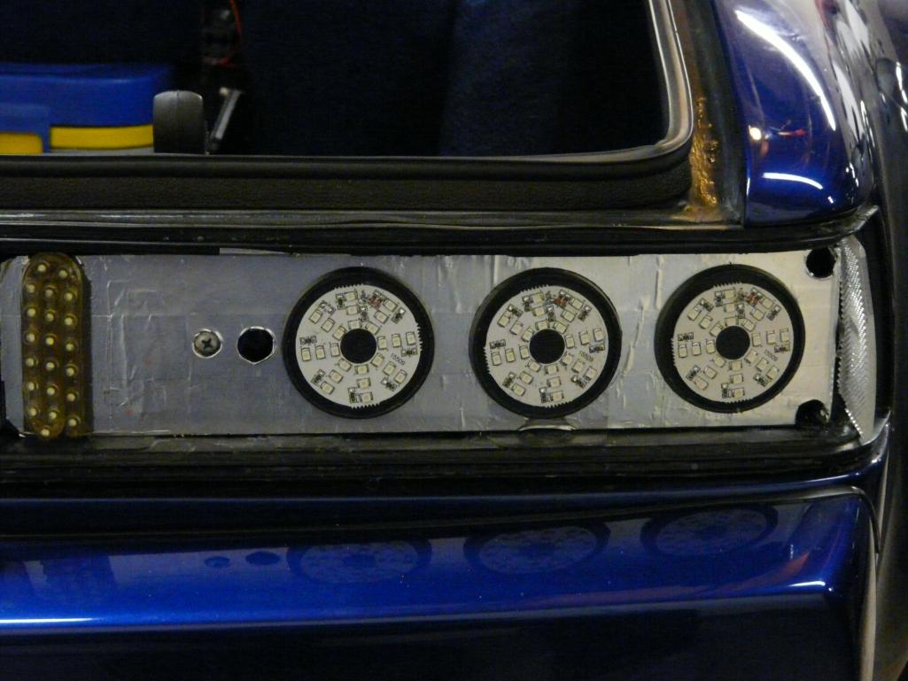

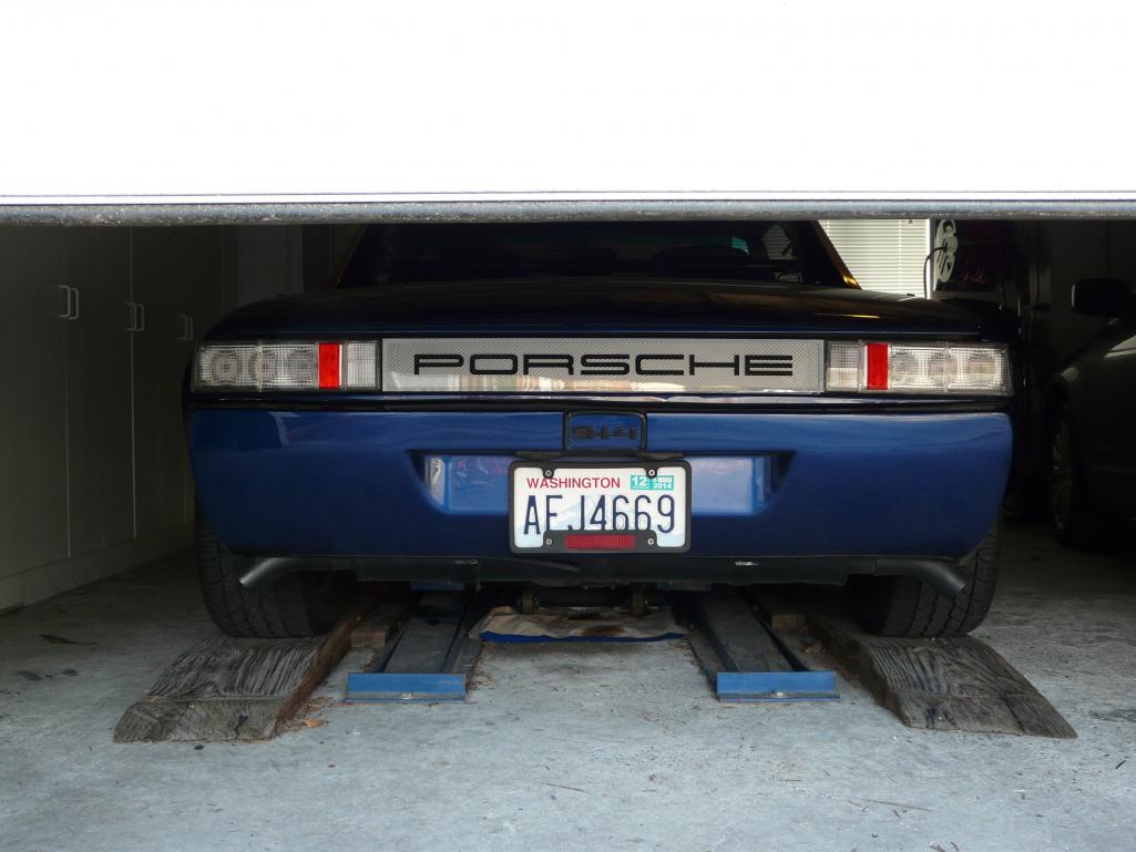

I also did the Cat-Eye LED front running/turn signal lights. So thought I could find something that I could change the rear tail lights to LED. On Ebay I found these round 2 3/4" LED lights that have a high and low feature. So I bought 6 of them, 3 for the right side and 3 for the left side. What I did is mounted 3 of them on a panel that would fit inside of the tail light assembly. Here are a couple pictures of how I did it.

pjhaun   I also did the Cat-Eye LED front running/turn sign...   Mar 13 2014, 04:44 PM
pjhaun   I also did the Cat-Eye LED front running/turn sig...   Mar 13 2014, 04:46 PM
