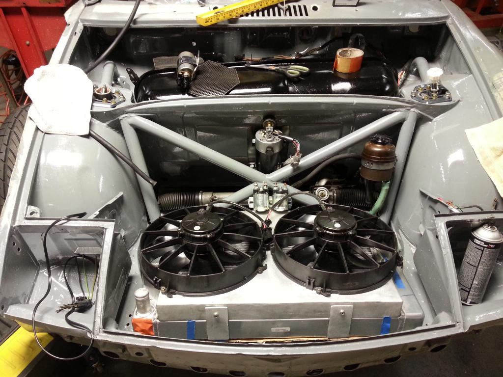

My fans arrived and I cut out the holes in the aluminum shroud. The two large relays
I'm going to use one for the 2 fans and 1 to run the power steering pump. I have to wire them into a new part of the cars electrical system. I'm going to setup a heavy power distribution center up front. Since I don't have room to place the battery in front I'm going to run a large long battery cable from the battery in the rear up front close to the fans and power steering pump relays. I want to make sure there's no or little amperage loss feeding these high electrical consumer's. I chose a 140 amp CS alternator to power the car. The rest of the car is going to use LED lights to lessen the load on my 45 year old wiring. Considering what happened to my Black 914 V8 car which burned up due to an electrical fire. (IMG:style_emoticons/default/blink.gif)

drive-ability   My fans arrived and I cut out the holes in the alu...   Mar 18 2014, 09:11 PM
