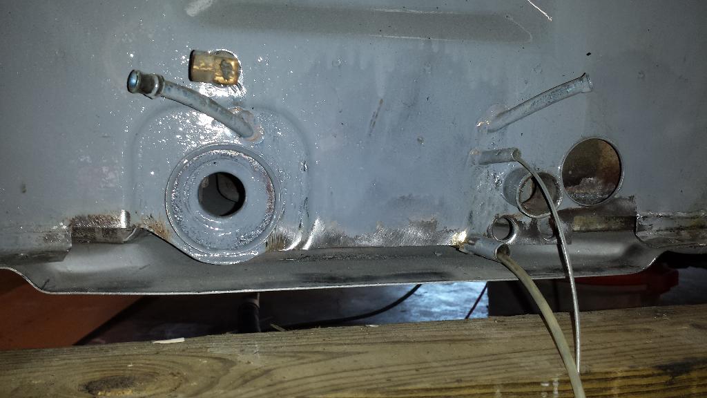

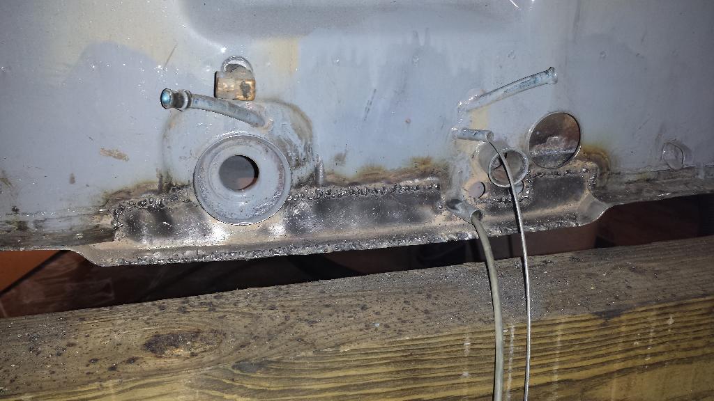

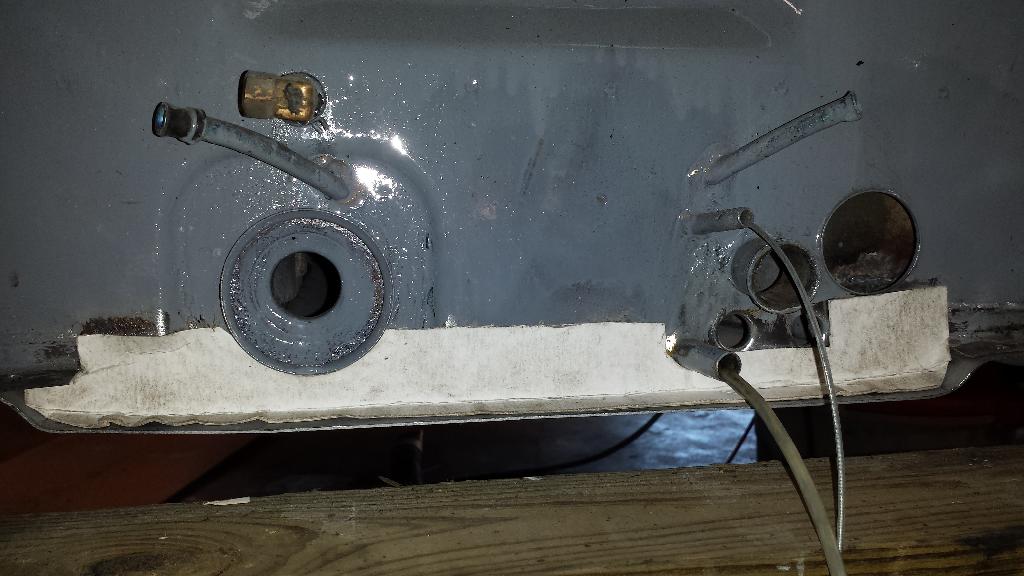

Finally got around to that small area under the clutch rod bushing. Fairly simple. Knocked it out in a couple hours.
